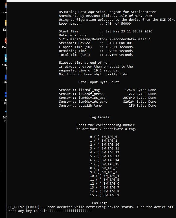

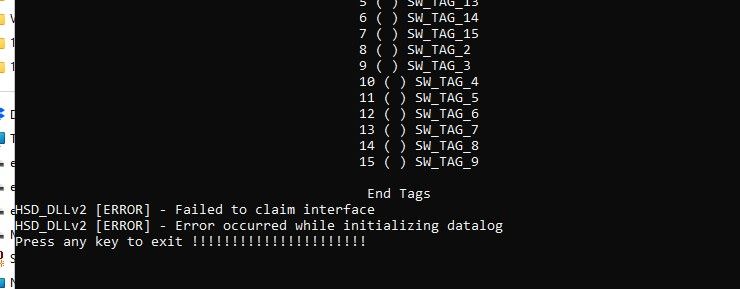

Sensor Tile Box Pro Software error messages
Smithson
The message is telling me what to do, it occurs quite frequently.  It comes from the locked DLL, any chance we could solve this problem.
The CX1 which was built in 2006 and is sitting beside your machine will nicely run 3,000,000 times, except the Intel NUC will not, but 1 million would be nice.
I know how to fix this issue without ST help, but that it is a pain, I would prefer the manufacturer to consider the problem.
1 REPLY 1
Smithson
How to solve the problem the simple way
1. Buy a managed hub from USBGEAR,  127 USD
2. Amend the CLI Example to exit on crash
3. Write a watching program that resets the port on the USB hub, then restart Clippy6, ie CLI_Example
4. How do I know this works, it is required for the 109 and 210 combination.
