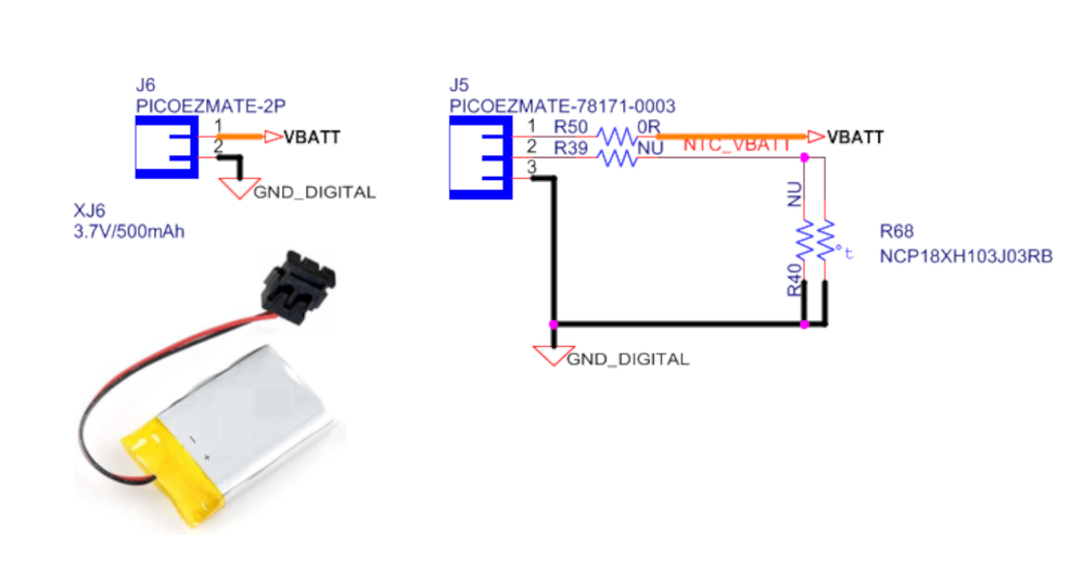

One more question. What is the designation for the battery connectors. I'd like to be able to source the connector with leads attached but I don't know the connector size or type or part number for replacement.
Thanks,
Tony
Hi Tony,
It is a Molex connector: you can find the component references in THIS POST, where you can also leave a like to @SGupt.4​ who found the correct part number =)
-Eleon
TJM
Senior II
Eleon, thanks once again. Checked the post and 'liked'.
Good call on checking the BOM.
For future reference, I happened to find the part number just by accident while looking over page 2 of the sensor box schematic.
