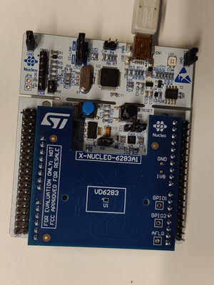

I've P-NUCLEO-6283A1 and downloaded the graphical user interface STSW-IMG301. The quick start guide does not seem to be up to date as I did not find "VD6283_setup.exe" I was supposed to install, just a plain exe in the zip.
At the first try GUI complained that it cannot communicate with the board. Next I updated the firmware with the GUI. Now when trying to start I get error complaining about invalid product version.
What is going on here? Does the GUI ship with incorrect firmware binary?
My board
Mulleteer
Turns out there is a new version of the ALS evalkit. The GUI worked with this one.
