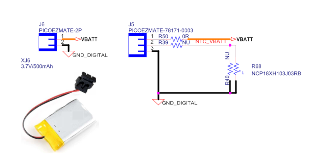

I own STEVAL MKSBOX1V1. Due to repeated disengagement of battery the wires of battery connector are ripped from the connector. I would like to know the model of the connector to fix the battery to the kit.

Thank you for the response . I had to search a little. I hope i have figured out the correct part number . Kindly validate (https://www.mouser.in/ProductDetail/Molex/36920-0201/?qs=T3oQrply3y99comCyd%2FYyA%3D%3D) if I have located the correct part.

Hi @SGupt.4​ ,
Ya, those cable and connector are not the most robust ones on the market...
You can find the complete BOM on the STEVAL-MKSBOX1V1 CAD resources webpage, at this link.
In particular, you should check the 2-pole molex connector J6 (78171-0002) and the corresponding connector (78172-0002) from battery side.
Hi @SGupt.4​ ,
this is the right one, thank you for having shared your search!

Thanks for identifying the cable and connector. Good call on checking the BOM. Just for additional information, I also found the part number on page 2 of the sensor tile box schematic.
0693W000008x4dbQAA.pngThanks,
Tony
