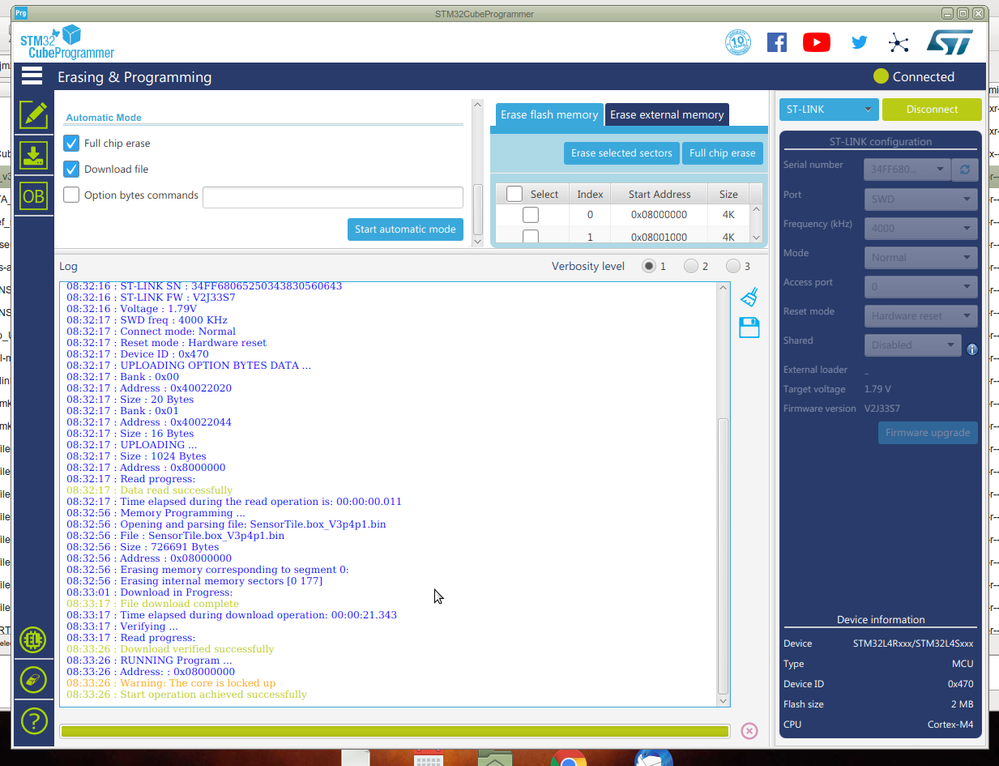

I captured it when the device asked for the update but the file may have gotten corrupted. Loaded v3.41 using STLinkv2 and the sensortilebox now appears to be dead. The file I have is 726691 bytes and doesn't appear to work. Sensortile won't boot, no LEDs.

Well, just checked and you are right... The version I shared with you was without the Bootloader code section. Please find attached the complete FW version. Regards

Eleon, thanks for the reply. The update will not take place using FOTA. I've tried with this phone many times and It only updated one time. Never could get it done successfully since then. The phone is a Motorola G5 Plus and the OS is Android 8.1. I've had problems with other things with this phone. However, I made the update with your file this morning using the STLinkv2 and I've attached the screenshot. The line at the bottom that says 'Warning: the core is locked up' after the upload completes is a bit disturbing. With v341 installed the sensortile box is dead and locked up with no activity. I can reflash the v335 back in and it will return to normal. What's your suggestion for this? Has anyone else had issues with the v341 update. Does it require some different settings in Cube Programmer? Here is a screenshot:
Loaded and worked perfectly. Thanks.
