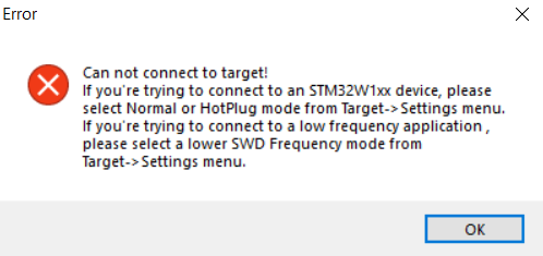

I have purchased a sensor-tile and would like to code said tile. The board is receiving power and the SWD connections are correct and double checked. Then when the st link is plugged in and one wants to debug and program the micro an error states that the target is not detected. Therefore I cannot code the micro. These are the only connections to and from the micro. I am using a ST-Link V2 to program this product. Also when the board has power I cannot pick it up through Bluetooth. Any help will be greatly appreciated.

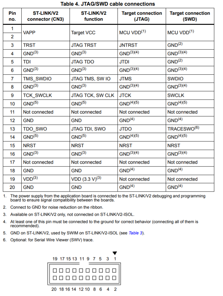

I have the official ST-Link V2. I am connecting the SWD interface to the bord using the pinout shown below.
Then when running a full chip erase a still get the same error I always get
And I have tried everything the error message suggests but still no change

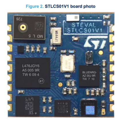

I am currently using the SensorTile module (STEVAL-STLCS01V1) shown below
I then connect its SWD pins to that of the ST link. I also have an ST link onboard one of my other ST dev boards that have SWD output to program external applications. I connect these SWD pins to that of the sensor tile and it still does not work. This procedure is followed in the getting set up guide provided but they use a Nucleo board with an ST link V2-1 onboard. I am wondering if it is possible to program the sensor tile with a ST link V2 instead of the ST link V2-1 or equivalent that they state in the guide.

No cradle board. Using the chip as is in the picture above soldered to connectors and only connecting the SWD pins on the chip to the ST Link. From the schematics there seems to be no additional circuitry required to connect the chip to the ST Link. Even if it is connected via the cradle board. Or did I miss something?
FBoth.1
Got it working. Was an issue with the board it was soldered to
