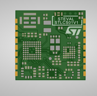

Sensor tile footprint - pinout, pitch, etc ?
Andrew Neil
The only documentation on the Product Page is the Data Brief - which is extremely brief!

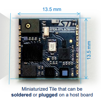

This marketing presentation gives overall dimensions (even those aren't in the Data Brief):
It tells us that it "can be soldered or plugged on a host board" - but there's no pinout or footprint details.

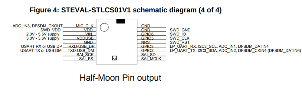

AScha.3

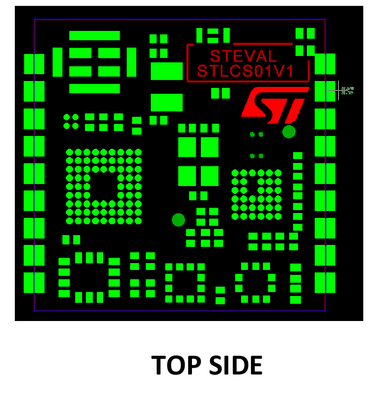

Look at the circuit...
https://www.st.com/resource/en/schematic_pack/steval-stlcs01v1_schematic.pdf
also Gerber files ...

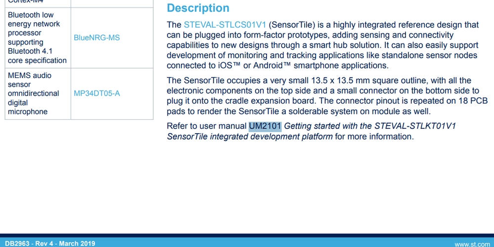

OK, so the Data Brief does mention UM2101:
but not as a clickable link, and it is not mentioned on the Product Page

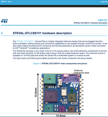

UM2101 does give the pinout:
but still not the pitch of the connections.
That also gives only pinout - not pitch.
PS:
You added mention of the Gerbers.
Yes, I'm sure it is in there - but, surely, this should be documented in the User Manual, or other human-readable document(s) ?
Chip datasheets give dimensioned package drawings ...
see the gerber files... :)
Again, this should be documented in the User Manual, or other human-readable document(s).
After all, chip datasheets give dimensioned package drawings ..
Ok....but it seems, STM expects you anyway buy the "mother board" also:
You can buy just the Tile alone:
https://estore.st.com/en/products/evaluation-tools/solution-evaluation-tools/sensing/steval-stlcs01v1.html
