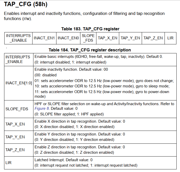

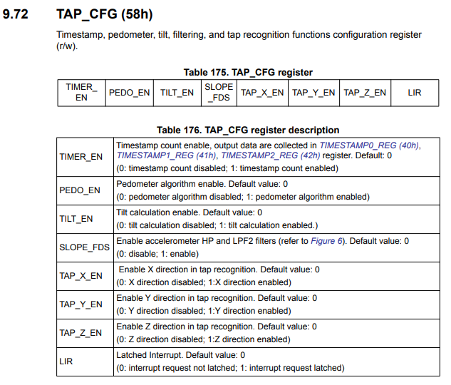

@Eleon BORLINI​
I check lsm6ds3_tilt.c
I found some problems:
 /* Enable Tilt function */
 lsm6ds3_tilt_sens_set(&dev_ctx, PROPERTY_ENABLE);
int32_t lsm6ds3_tilt_sens_set(stmdev_ctx_t *ctx, uint8_t val)
 lsm6ds3_ctrl10_c_t ctrl10_c;
 lsm6ds3_tap_cfg_t tap_cfg;
 int32_t ret;
 ret = 0;
 if (val == PROPERTY_ENABLE){
  ret = lsm6ds3_read_reg(ctx, LSM6DS3_CTRL10_C, (uint8_t*)&ctrl10_c, 1);
  if(ret == 0){
   ctrl10_c.func_en = PROPERTY_ENABLE;
   ret = lsm6ds3_write_reg(ctx, LSM6DS3_CTRL10_C, (uint8_t*)&ctrl10_c, 1);
 if(ret == 0){
  ret = lsm6ds3_read_reg(ctx, LSM6DS3_TAP_CFG, (uint8_t*)&tap_cfg, 1);
 if(ret == 0){
  tap_cfg.tilt_en = (uint8_t)val;
  ret = lsm6ds3_write_reg(ctx, LSM6DS3_TAP_CFG, (uint8_t*)&tap_cfg, 1);
 return ret;
#define LSM6DS3_TAP_CFG              0x58U
typedef struct {
 uint8_t lir             : 1;
 uint8_t tap_z_en          : 1;
 uint8_t tap_y_en          : 1;
 uint8_t tap_x_en          : 1;
 uint8_t slope_fds          : 1;
 uint8_t tilt_en           : 1;
 uint8_t ****_en           : 1;
 uint8_t timer_en          : 1;
} lsm6ds3_tap_cfg_t;
TAP_CFG (58h) have tilt_en bit?
I check LSM6DS3TR-C datasheet DocID030071 Rev 3.
I can not find tilt_en bit in TAP_CFG.
but CTRL10_C (19h) have tilt_en bit
I enable the sensor tilt function in my device by blow codes from AN5130 - Rev 1.6.3 Relative tilt.
1. Write 20h to CTRL1_XL // Turn on the accelerometer // ODR_XL = 26 Hz, FS_XL = ±2 g
2. Write 0Ch to CTRL10_C // Enable embedded functions // Enable tilt detection
3. Write 02h to MD1_CFG // Tilt detector interrupt driven to INT1 pin
please confirm it. thank you!
Hi @Community member​ , uhm... thank you for your notification, I'll share it internally to our C library developer. You should be right: is it working with the tilt_en bit bit of CTRL10_C (19h) register? Regards
Eleon BORLINI
Hi @Community member​ , internally checked, and please note that the LSM6DS3TR-C and the LSM6DS3 part numbers are different devices with different datasheets. The LSM6DS3 has a TAP_CFG (58h) register tilt_en bit, so the code is correct. Regards
ZhangTao
@Eleon BORLINI​ ,thank you!
I check my chip.
