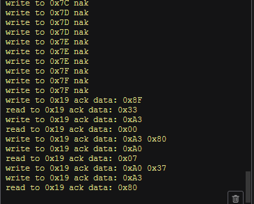

HI @Eleon BORLINI​
That works, 0693W00000aIgZwQAK.png1) I have just understand that DMA have no sense with I2C becouse a fifo reading for 192 bytes is the same, is not it?
is it possible create a dma for this? The difference iss that the processor is free during the i2c transaction.
I am trying to make a i2c reading of 192 i2c after int1 event is detected. That event could be with ov or watermaker 2/3 fifo.Is that correct?
2) LIS3DH is not real 5kHz Bw is only OutputSR. Does it exits any device in st roadmap with (>3-4kHz BW) >OSR?
kind regards, tcg
2)
​ Hi @Eleon BORLINI​
That seems that work well.
But I am not able to control the INT1 with watermark o ov fifo. Any idea?
It is a little spaguetti code...
Thanks for all.
