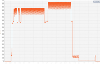

VL53L1X standby power consumption too high in the ULP driver
qqzlqqzlqqzl
Hello ST team, as mentioned in the title, I found that the power consumption when using the ULP library to drive TOF L1 is inconsistent with the manual. I'm using the official evaluation board vl53l1-satel. Below is my test code and power consumption data. In my code, you'll see both ULD and ULP libraries, but I'm actually only using the ULP library; the ULD library is commented out.

John_Kvam
Senior II
The CB code had an issue and it was decided to fix the issue with a patch to the code on the sensor. But that means that one has to keep the sensor alive enough to not lose the memory. And that is why the histogram parts do not go into their lowest power setting.
However, that patch is not used in the non-histogram parts. And it should be a lot lower than the 17ma shown in your plot.
And especially the ULP driver should get down to zero.
Could it be that you are measuring something in addition to the power used by the sensor? When I was doing this, I inadvertently was measuring some pull-up voltage. (I blame my software background.)
but if you power consumption is too high, ensure the interrupt is clear, and the I2C lines are both high. It's really all I can think of.

My main confusion is why there are still several mA of power consumption when the TOF rangefinder completes measurement and enters software standby mode. My MCU and TOF have separate, independent power supplies. Also, when using the ULD library, the power consumption after ranging completion and entering software standby is only a few μA, which is consistent with the manual. Therefore, I don't think it's an issue with my hardware connections.When I pull XShut low, it consumes about 400μA of current at 2.8V supply (all my power to the TOF is 2.8V)。I also made some modifications to the circuit, removing the voltage regulator chip and shorting R21 to get closer to the device's power consumption, but I didn't remove the level shifting chip because when I removed this chip, the TOF stopped working for some reason.

Can you use the debugger to find out when the power consumption goes high? Is it high before the first range?
I just took the stock standard example code and the Nucleo-F401RE eval kit board and I did NOT get the issue.
But I've seen it.
One explanation was that we were loading a patch to help with the phase calibration. And if that patch is running the sensor cannot go into the lowest power mode. It's there to increase the accuracy a tiniest bit. But it should NOT be enabled unless you are running in 'continuous mode'. If you want a gap between each range, you are in autonomous mode, and it should not be enabled.
Look for the function load_patch() in your VL53L1X_SensorInit() routine. If it's there, get a newer version of the driver. Or just delete the line.
But I'm still betting it's the level shifter.

This took me forever, but I have an idea.
I ranged and read out the data, printing it. I then cleared the interrupt.
On my power plot you can see the high-power ranging, then the lower-power I2C access. Then (after the print time) you can see the I2C command to clear the interrupt. Then the chip goes into lowest power.
I then ran the SAME code, but moving the clearing of the interrupt BEFORE I read out the I2C data.
Note how the power consumption goes nearly to zero just after the I2C reads.
So I'm suggesting you clear the interrupt before you do anything else.

Hopefully that works. My theory is the sensor will not go into lowest power until the interrupt is cleared.
BTW: I used the SATELLITE VL53L4CD sensor and the X-Nucleo-LPM01A with the STM32CubeMonitorPower software to do the analysis.
If this or any post solves your issue, please mark them as 'Accept as Solution' It really helps. And if you notice anything wrong do not hesitate to 'Report Inappropriate Content'. Someone will review it.
qqzlqqzlqqzl
Thanks for your suggestion, but I still haven't achieved low power on VL53L1CB.
