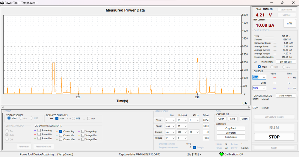

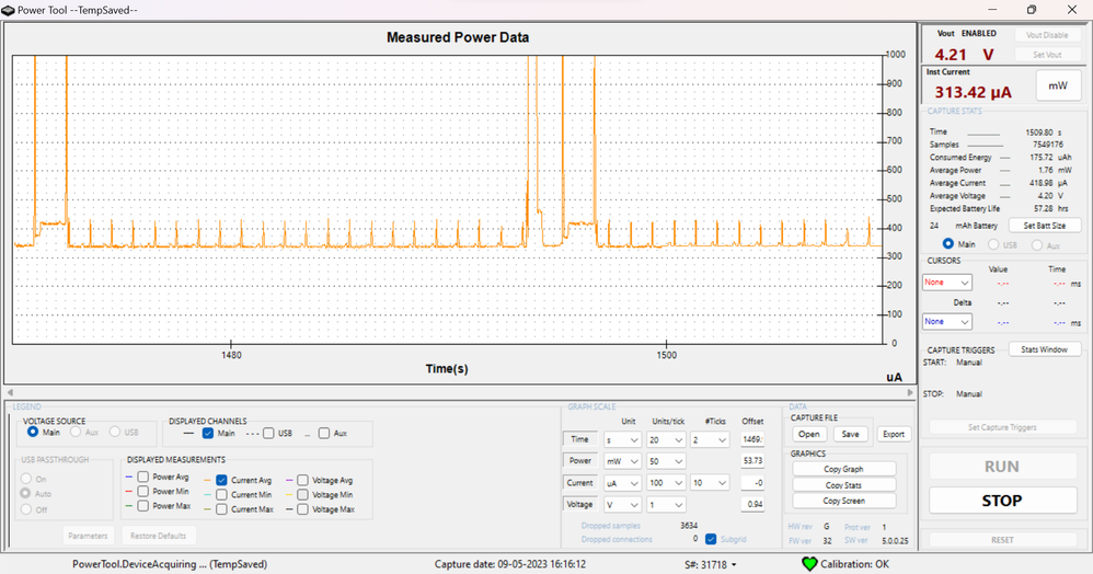

2023-05-09 4:12 AM - edited 2023-11-20 6:24 AM
Attaching for reference
2023-05-09 4:28 AM - edited 2023-11-20 6:24 AM
And this is when the module ideally works
2023-05-10 1:27 AM
the power consumption depends on both accelerometer and gyroscope ODR, and the MLC algorithm consumes power too.
it is strange that it does not return to lower levels when disabling MLC, but are the ODR at 0?
