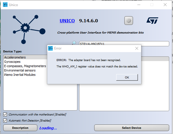

The WHO_AM_I register value does not match the device selected
TZapp.1
I am using a STEVAL-MKI109V3 mother board to evaluate 2 accelerometers :
  • LSM6DSOX (STEVAL-MKI197V1)
  • LIS2DUXS12
I want to use the GUI software UNICO v9.14.6.0 but when I want to connect my device, an error popup appear : "ERROR : The adapter board has not been recognized. The WHO_AM_I register value does not match the device selected".
I have updated the motherboard firmware with the v3.48.3 but I still have the problem with my 2 MEMS boards ...
Can someone help me ?

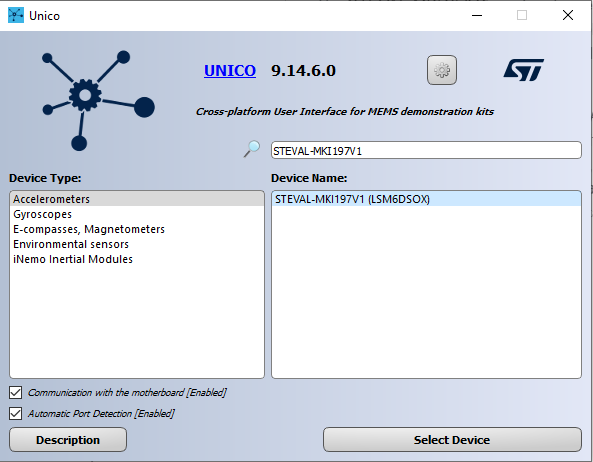

Hi @Federica Bossi​ ,
Thank's for helping me.

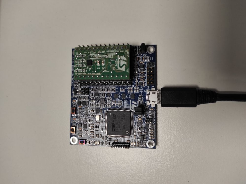

Here is the steps I followed :
  • Connect my MEMS board (STEVAL-MKI197V1) on the STEVAL-MKI109V3
  • Plug it in my computer
  • Launch UNICO v9.14.6.0 software and select "STEVAL-MKI197V1" in the Device Name table
  • Click on Select Device and here is the error popup

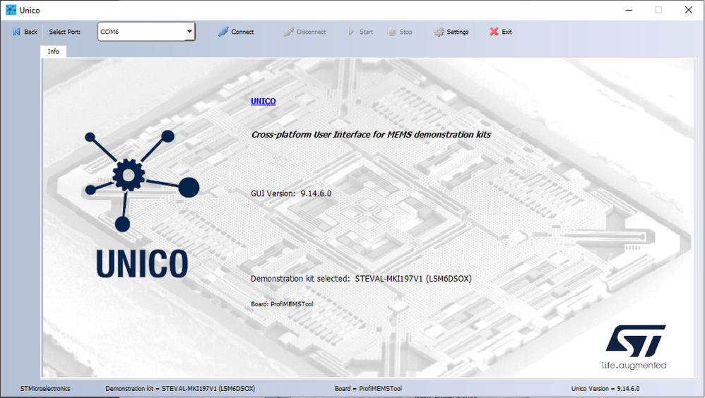

  • Click on OK and here is the main window but I still can't connect ..
  • Tried to click on connect but same error popup appear
  • Tried to go back and select a second time the device name put same error pop-up

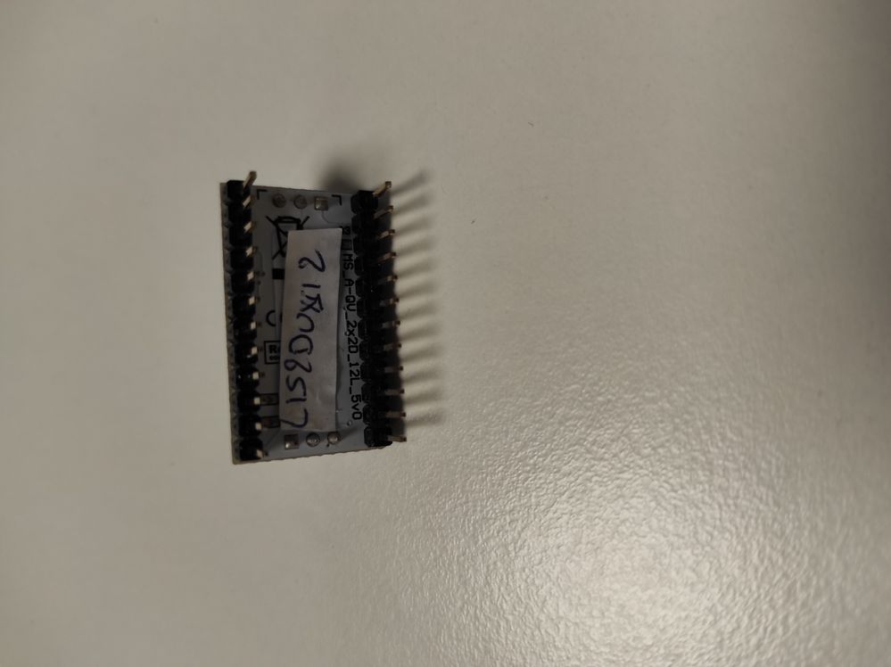

  • I tried with another MEMS board which is a bit different but it is the same scenario

Hi @FKara.3 , @B3r ,
Please can you share a picture of your STEVAL-MKI109V3? So that I can check if your jumpers are ok.
