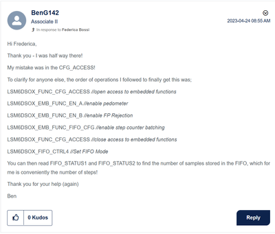

Screenshot from the closed thread mentioned by @Andrew Neil (Credit to @Federica Bossi) :
@BenG142
Thank you for your help, BenG142. Thanks to you, I solved my problem, and the LSM6DSOX is working as I wanted.
