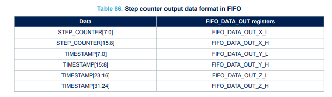

The FIFO can be configured to store pedometer data.
Data can be retrieved from the FIFO through six dedicated registers, from address 79h to 7Eh: FIFO_DATA_OUT_X_L, FIFO_DATA_OUT_X_H, FIFO_DATA_OUT_Y_L, FIFO_DATA_OUT_Y_H, FIFO_DATA_OUT_Z_L, FIFO_DATA_OUT_Z_H.
Through the FIFO_MODE[2:0] bits of the FIFO_CTRL4 register you can choose the FIFO operating modes you prefer. To monitor the FIFO status two dedicated registers are available: FIFO_STATUS1 and FIFO_STATUS2.

You can then read FIFO_STATUS1 and FIFO_STATUS2 to find the number of samples stored in the FIFO, which for me is conveniently the number of steps!

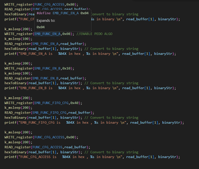

‎2024-08-13 4:01 AM
Hi BENG,
I'm trying to develop a pedometer application using the LSM6DSOX sensor, but I haven't been successful. Could you share your project files with me? I'd like to know which registers you used.
‎2024-11-18 6:47 AM
Hi Federica Bossi,
I have set the register according to your suggestion, but still cannot get FIFO reading
FIFO_STATUS_1 is 00
Any other suggestions?
