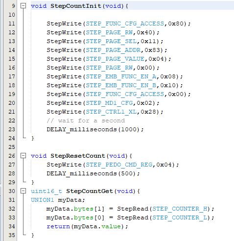

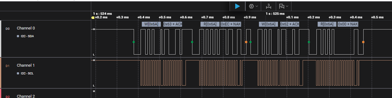

I designed a special board that includes the LSM6DSO32 sensor. I want to get step count data, for testing I am using ESP32-CAM with LSM6DSO32 via I2C. I have followed the basic routine mentioned in application notes. I can get only garbage value. I will attached sample code for reference. Can you check and help me step by step what to do? First code give step count 0 always. For second code I attached screenshot. Please look into it and tell if anything need to change.

void initSensor() {
    Serial.println("Initializing Sensor...");
    // Step 1: Enable access to embedded functions registers
    writeRegister(FUNC_CFG_ACCESS, 0x80);
    // Step 2: Select write operation mode
    writeRegister(PAGE_RW, 0x40);
    // Step 3: Select page 1
    writeRegister(PAGE_SEL, 0x11);
    // Step 4: Set the embedded advanced features register (PEDO_CMD_REG)
    writeRegister(PAGE_ADDR, 0x83);
    // Step 5: Enable false positive rejection block
    writeRegister(PAGE_VALUE, 0x04);
    // Step 6: Disable write operation mode
    writeRegister(PAGE_RW, 0x00);
    // Step 7: Enable pedometer
    writeRegister(EMB_FUNC_EN_A, 0x08);
    // Step 8: Enable pedometer false-positive rejection block and advanced detection feature
    writeRegister(EMB_FUNC_EN_B, 0x10);
    // Step 9: Route step detection interrupt to INT1 pin (temporarily disable this for now)
    // writeRegister(EMB_FUNC_INT1, 0x08);
    // Step 10: Disable access to embedded functions registers
    writeRegister(FUNC_CFG_ACCESS, 0x00);
    // Step 11: Enable routing of the embedded function interrupts
    writeRegister(MD1_CFG, 0x02);
    // Step 12: Enable accelerometer (26 Hz, ±8g)
    writeRegister(CTRL1_XL, 0x28);
    delay(2000);  // Increase the delay for initialization time
    Serial.println("Sensor Initialized!");
uint16_t readStepCounter() {
    byte stepCountLow = readRegister(STEP_COUNTER_L);  // Read low byte
    byte stepCountHigh = readRegister(STEP_COUNTER_H);  // Read high byte
    uint16_t stepCount = (stepCountHigh <<  | stepCountLow;  // Combine into 16-bit unsigned value
    return stepCount;
void resetStepCounter() {
    Serial.println("Resetting Step Counter...");
    writeRegister(PEDO_CMD_REG, 0x04);  // Reset the step counter (use 0x04 instead of 0x01)
    delay(500);  // Wait for reset to take effect
    // Verify the reset by reading step count
    uint16_t stepCount = readStepCounter();
    Serial.print("Step Counter After Reset: ");
    Serial.println(stepCount);
byte readRegister(byte reg) {
    Wire.beginTransmission(LSM6DSO32_ADDR);
    Wire.write(reg);
    Wire.endTransmission(false);
    Wire.requestFrom(LSM6DSO32_ADDR, 1);
    return Wire.available() ? Wire.read() : 0;
void writeRegister(byte reg, byte value) {
    Wire.write(reg);
    Wire.write(value);
    Wire.endTransmission();
I would appreciate if you some ways to get step count data, that would be great.
Thanks You

Federica Bossi
Hi @rex2 ,
Can you try this code and let me know if you get consistent data?

I have essentially the same code as above, however its being run on a Microchip MCU in C.
In my code I initialize the IC, then wait 1second, reset the count, wait 100ms and then read the count.
When I read the count I get consistently EC 00
Do you see any error in what I am doing
