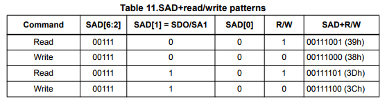

Sadra nsh
Posted on April 05, 2017 at 12:25
‌ Are u sure? Have you connected 4 lis3mdl sensors on one I2c bus?
as mentioned on page 17 of datasheet it has only 2 address(
00111x0b
) so only 2 sensors can be on one i2c bus
Posted on April 05, 2017 at 15:36
Yes i am sure.
For static addresses it is right that only 2 sensors can be used at one IIC bus. But if you connect the SDO/SA1 pin of the sensor to a GPIO pin of the MCU you can switch dynamically the addresses and with this fact you can connect as much sensors as you want (and you can drive the capacity) to the bus. The one sensor you will talk to get the address
0011100b all others 0011110b later you switch your GPIOS and this Sensor get 0011110b and the new one you will talk to get 0011100b and so on.
Posted on January 11, 2018 at 08:52
I have the same problem. When I cut the pin 9 line to gnd the power down current drop to correct about 1uA value. Then magnetometer I2C bus did not work anymore. Then I connected it to VDD. Current was ok but bus was still broken. Is it really so that the line needs to be connected to IO and to switch up and downd debendin on mode?
Posted on January 11, 2018 at 09:27
jussi.mutila
‌ can you be more specific? What do you mean by the same problem?
If you use the I2C bus (CS connected to VDD_IO) the pin 9 (SDO/SA1) needs to be connected either to VDD_IO or to GND and it definesonebit of the device address.
