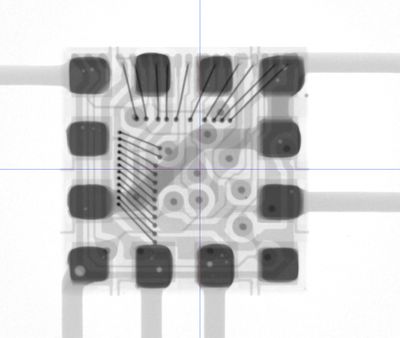

nikosandreadakis
Hello @npreel
I have already pulled the INT/DRDY pin to GND, but the power consumption is still higher than the value specified in the datasheet.
Could you share what equipment and setup you are using for the current measurements?
Also, please make sure the device is not being unintentionally powered during low-power mode through other pins, such as communication lines with external pull-ups. To verify this, try completely isolating the IC from the communication pins and repeat the measurement. 
Below i have upload a X-ray sample of effected chip.
Best Regards,
Nikos.

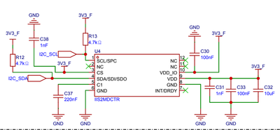

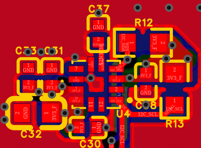

Hello @nikosandreadakis
I am using a Power Profiler Kit 2 and a lab generator to do my tests.
I measure the consumption of my entire board that must be around 30 µA.
With the schematics below, I measure ~450 µA.
The current consumption is unstable and is sensitive to magnetic field variations, which is why I initially suspected the floating INT/DRDY pin.
As I sais, with a pull down (20K) this consumption disappears.
Unfortunately, my IIS2MDC is integrated on a PCB and I will be unable to disconnect communication pins without being too destructive. But I will end up doing it, and share my updates here.
Indeed, my consumption may come from back powering thought I2C and its 2 pull up. However, this consumption didn't happen on my previous PCB generation. The magneto routing didn't change at all. Its package is the following : LGA-12_L2.0-W2.0-P0.50-TL
Here are my schematics :
Best Regards,
Nicolas
