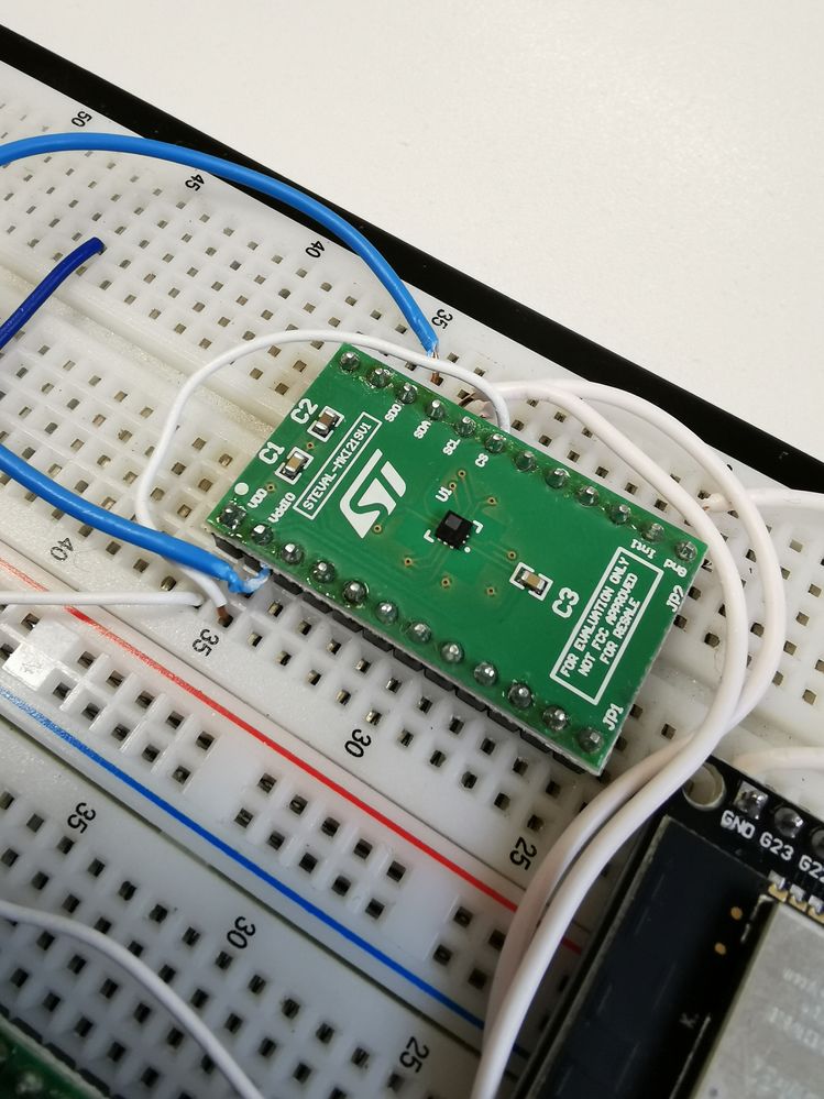

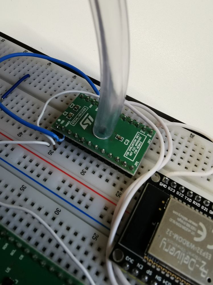

AMaro.2
The structure is provisional. I press the hose against the circuit board and suck on the hose. I feel that the negative pressure is not escaping.0693W00000DqBi0QAF.jpg0693W00000DqBhWQAV.jpg
Hi @AMaro.2​ ,
are you sure you are sealing well the tube on the adapter?
If not, the air pressure will be almost equal to the ambient one.
You might try to seal the tube on the adapter with hot glue, if you can.
-Eleon
I'm actually pretty sure that the pressure of the hose against the plate is tight.
