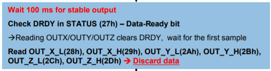

i'm using the LIS3DSH to read data in different sampling rates (from 25 up to 1600), but in some cases i notice the first data in Z axe is not correct (some times it's too low or too high, for example, first data is -0.7g (or -1.5) and the rest are around -1g) and this happen with a random sampling rate, somethings happen when i use 100 hz and sometimes when i use 400 or 800. i even changed the anti-aliasing but i had no luck, the only think i can do is to wait until the value is updated in the sensor so i can get the next value at the start.

Hi @Hjoma.1​ ,
A good general practice when you start collecting the data from a sensor after you have configured it, is to drop the first acquisition.
This is important especially when the (raw) data are then used to feed functions or algorithm involving integration steps, such as the calculation of the speed and the displacement from the acceleration.
The reason is that the internal logic of the sensor begins processing the signal when activated, and it the computation it might enter a value that is coming from the assessment phase of the MEMS, thus affecting the .
For example, if you have a look to a common accelerometer application note, such as the LIS2DW12 one, when the self-test procedure is described (p.45) it is suggested to discard the first converted sample, to avoid artifacts in the measure.
The suggestion is then to wait the Boot time after the startup phase (typ 5/10ms), configure the register and the start the acquisition discarding the first sample.

Hi @Eleon BORLINI​
Your answer was correct, i had to do few tests and i found out it's not only the first value, but the couple first values are wrong.
Thank you for your help
