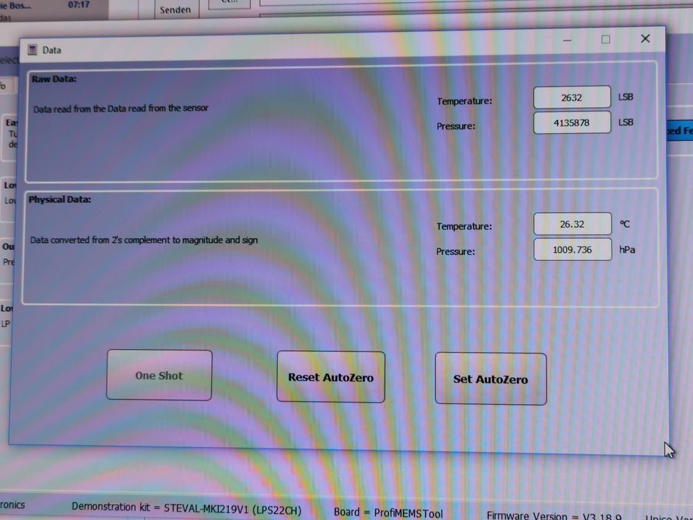

At the weekend I got a STEVAL-MKI109V3 board on loan with which I can use the same STEVAL-MKI219V1 sensor.
Starting the UNICO GUI software is successful and the sensor is also correctly recognized.
The plot shows the temperature and pressure.
The temperature changes as soon as I put my finger on the sensor.

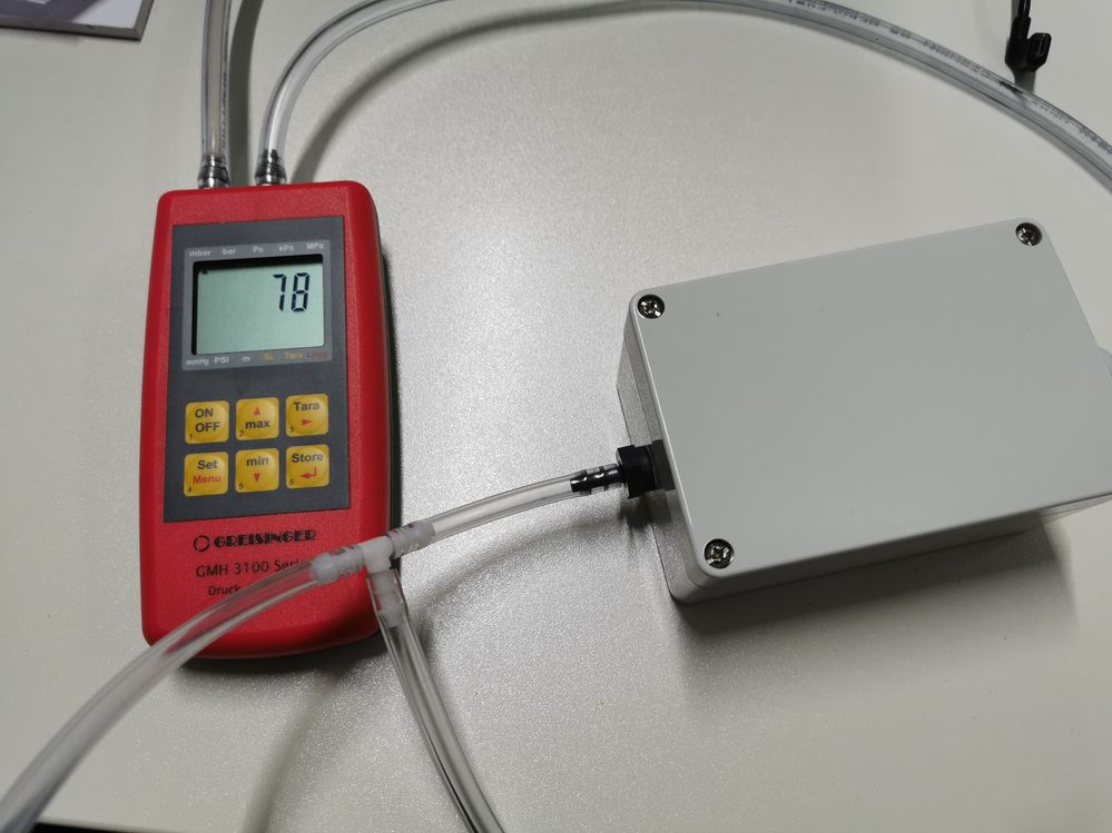

Now to the negative pressure: I started the same experiment as I did before as shown in the two pictures.
This time to confirm that the system is tight, I hung another vacuum measuring device in the line.
The negative pressure on the second measuring device is displayed correctly.
Unfortunately not from the lps22ch?
The negative pressure value only changes when the temperature changes.

To confirm that my application is tight, I installed the board with the sensor in a separate housing.
Unfortunately, the value does not change in the Unico GUI.
The GREISINGER measuring device shows a negative pressure of approx. 78 mbar in the housing.
Thus the value in the Unico GUI should show approx. 931 hPa.0693W00000DlYyaQAF.jpg0693W00000DlYyVQAV.jpg0693W00000DlYyQQAV.jpg

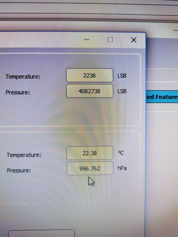

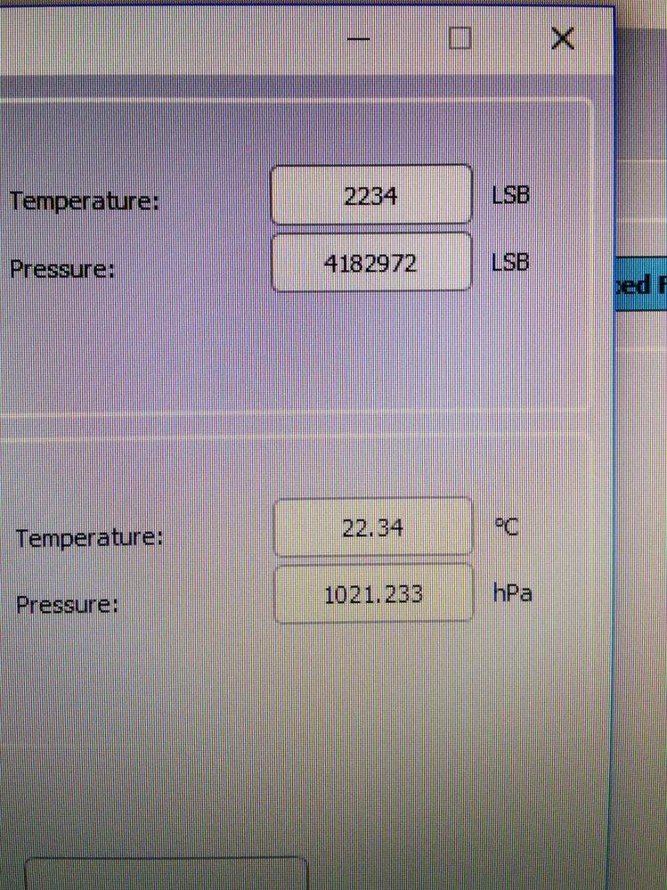

oh yes I forgot to mention that the 78mbar are relative.
I have two of the sensors.
Which also amazes me that the two sensors will display different ones when idling.
one sensor shows 1021 hPa absolute when idling and the second sensor 996 hPa.
I don't understand why the values show such a large difference.
But nonetheless, when I create a negative pressure, both show no change.0693W00000DlqGgQAJ.jpg0693W00000DlqGbQAJ.jpg

when i don't blow but when i breathe, i.e. warm air, the value changes.
As I have already described before that the pressure only changes when I put my finger on it and the sensor assimilates my body temperature.
the device does not hang because the temperature changes yes.
Hi @AMaro.2​ ,
so it looks as the pressure is varying only with temperature, for example when the chip is heated.
This would indeed resemble a "contamination" issue like clogged holes, as suggested by OLS team.
