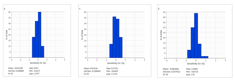

For an idea on the accuracy of those thresholds, you should refer to the mechanical characteristics of the device as reported in the datasheet, p.11.
First you have to minimize the Zero-g level offset accuracy, that is ±20mg. After this "zero calibration", you can refer to the reported sensitivity, for example the min sensitivity in the FS ±2g, i.e. 0.207mg/digit, it should result in less than 1 degree precision.
This concept is fairly related to the Sensitivity error (in acceleration). I can share you this value for the FS ±2g case.
Please let me know if it can be of some help.
