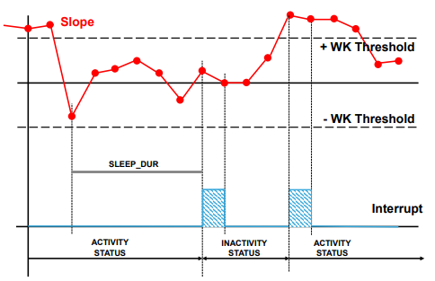

Activity/Inactivity Interrupt Issue:
At least one fake activity/inactivity interrupt is generating when power on the device if we configured with accelerometer lower data rate (less than 208Hz)
For this operation, the detection should work also with ODR=12.5 Hz... Did you try to increase the threshold value in the  WK_THS[5:0] bits of the WAKE_UP_THS register? Or are you sure to distinguish inactivity from activity interrupt? (You might receive an Inactivity interrupt after sometime and you could consider it as a fake interrupt). (Image from same app note, p.54)
