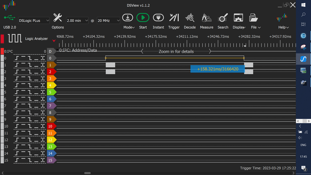

0693W00000bh7PlQAI.pngI am using LIS2DTW12 MEMS,
1. I configured this sensor in continuous mode.
2. Set the FIFO threshold to 16 samples.
3. Selected ODR register value is 100.
4 Selected Low power 1 mode.
Expected:
Periodic interrupt from FIFO must happen every 160ms. But I am getting FIFO interrupt at ~158.4ms.
Could you please explain the cause of this time drift and how to fix it?
Note: our operating temperature range is -5 to 60 degrees C.

Hi @HHP.1​ ,
Welcome to ST Community!
Looking at the data, a FIFO interrupt at 158.4 corresponds to measure an ODR of about 99Hz.
We measure the ODR accuracy only on characterization data and so we can't guarantee min-max values in production but measuring 99Hz instead of 100Hz is acceptable according to our data.

Hello @Federica Bossi​ ,
Thank you for your response.
Is there any way to accumulate this frequency drift?
Can you give detailed information on ODR accuracy in terms of %error?
Federica Bossi
Hi @HHP.1​ ,
A drift over time is not expected.
I can't give you detailed information because ODR Accuracy is not a tested parameter in production but according to characterization tests on a limited samples of data you can consider approximately up to 10%.
