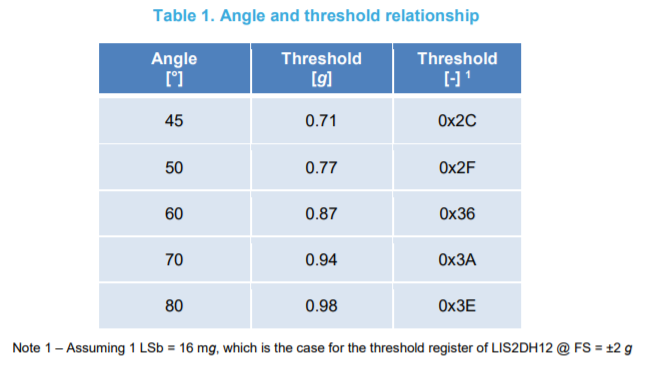

For reference this is how I calculate the threshold value:
for 45 degrees threshold angle -> 724 mg, 1LSB in THS is 16 mg so 724 / 16 = 45 (0x2D), expected output threshold @ 724/ 4 mg (1 LSB = 4mg in output registers) = 181 (0xB5)
for 30 degrees threshold angle -> ~512 mg, 1LSB in THS is 16 mg so 512 / 16 = 32 (0x20), expected output threshold @ 500/ 4 mg (1 LSB = 4mg in output registers) ~= 128 (0x80)

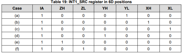

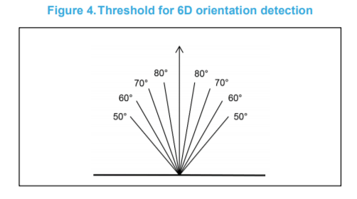

‎2021-10-11 7:05 AM
Hi @ilg​ ,
Calculations looks good from my side.
In a 6D orientation detection, 45° is the discriminant between an orientation and another one, since 44° along x are 46° along -x.
So I believe you should get an interrupt in any case, but with different flags risen in the INT1_SRC register.
For the 6D orientation, the INT1_THS is set to 0x21 (see app note AN5005, p.28).
Check also this design tip note: Setting up 6D orientation detection with ST’s MEMS accelerometers.
The tilt detection is limited to 45° for symmetry.
-Eleon

‎2021-10-11 10:56 PM
Yeah I figured as much since the breaking point was 45°, which overlaps with the other adjacent axis. However, since I didn't find it described in the documentation I thought I'd try and ask. Thank you for the fast and complete answer :)
