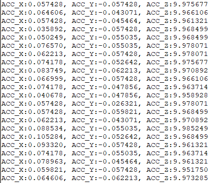

I am getting acceleration and gyro data using LSM6DSO32 chip. But I want to filter this data with internal filters, but I cannot activate the high pass filter of the accelerometer.
Buse
I am getting acceleration and gyro data using LSM6DSO32 chip. But I want to filter this data with internal filters, but I cannot activate the high pass filter of the accelerometer. In the code below, I want to send F4 (11110100) data to the CTRL8_XL control register, ie 0x17 register address specified in the datasheet, to set the cutoff frequency as ODR/800, but corruption occurs in the accelerometer data. How can I solve this?

Buse
I think LPF2 and HPF can not be enabled at the same time for the accelerometer. For this, I did not enable LPF2. Do I need to enable LPF2? Correct me if I'm wrong. The ODR I use is 104 Hz, but even when I do ODR/2, I see my accelerometer data incorrectly as shown in the figure. I also don't know how to fix this error.0693W00000Kd9gJQAR.png

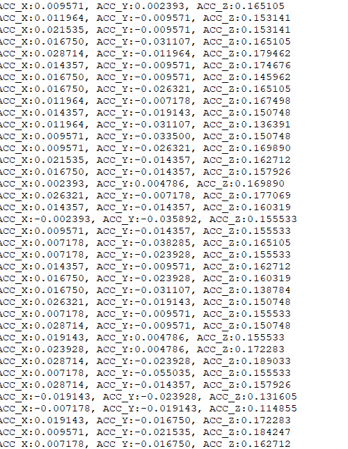

Buse
Hi @Eleon BORLINI​ ,
Thanks for your answer, my problem is solved as seen in the figure below. I sent the value "10000001" ie. 0x81 to the Z_OFS_USR register.
I have 2 more questions on this topic. First question is, do I need to set off-set values within these values, although there is no problem in the X and Y axis? What does this get me? Second question is, How much should I set these off-set values for? Can you explain what it means to be between -127 and 127? I sent 0x81, but I sent it randomly, not on purpose.

HI @Buse​ ,
please consider that the LSB for the offset is defined in the datasheet, p. 72:
0693W00000LxLeYQAV.pngSo, if this bit is 1, the +127 / -127 LSB has to be multiplied to 2^-10g/LSB in order to get the value in g / mg.
In your case, 0x81 = dec 129 = 0.126 g = 126mg.
Similar calculation if USR_OFF_W == 1.
