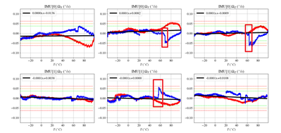

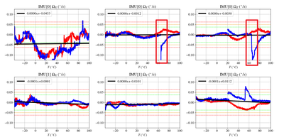

I performed a temperature cycle check on the ASM330LHB chip. Relative to the warming process (red curve), during the cooling process (blue curve), it is prone to large zero-bias jumps (in the red box of the picture)。
The jump during the cooling process, I feel like there is a correction mechanism in the gyro in the chip, which recognizes a large shift in the gyro zero bias during the cooling process, and then immediately corrects the large zero bias shift.
Can you please help explain what causes this?
Note: These data on the image have been smoothed for 10 seconds.

Hi @dayu ,
That's very strange. Can you give me more details about your setup and your test?
Thanks.

We are putting 2 IMU chips on the same PCB. The temperature is lowered from about 30°C to -40°C, then raised from -40°C to 100°C, and then lowered from 100°C to about 30°C. The temperature is lowered at a rate of 1°C/min. The temperature is raised and lowered at a rate of 1°C/min. During the cooling process, large gyro bias jumps are likely to occur.

It could be something related to the soldering process that causes some stress to the mems.

But why does this large gyro bias jump only occurs during the cooling process and not during the warm up process?

Good day. I am experiencing the same problem(I raise and cool the the temperature with 1deg/min from -30 to 60 to -30deg ,the gyro bias changed during cooling @ temperature of 30deg). Did you got any solution?

 My gyroscope bias also jumps have been observed at certain temperature points. Did you got any solution?
