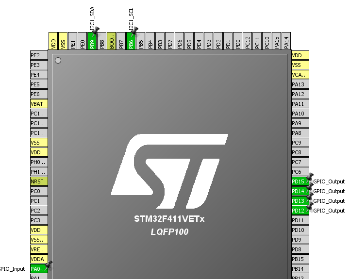

Hey
I'm trying a new board, this is the stm32f411e-disco and I can't read acc. values, they are always 0x00
I've generated the project with STM32CubeMX V4.9.0
The config and the main code are below:
&sharpinclude ''stm32f4xx_hal.h''
I2C_HandleTypeDef hi2c1;
HAL_StatusTypeDef acc_ready, acc_read;
uint8_t readXYZ[6];
static void MX_I2C1_Init(void);
int main(void)
  HAL_Init();
  SystemClock_Config();
  MX_GPIO_Init();
  MX_I2C1_Init();
  HAL_I2C_MspInit(&hi2c1);
  while (1)
    HAL_Delay(1000);
    HAL_GPIO_TogglePin(GPIOD, GPIO_PIN_15);
    HAL_GPIO_WritePin(GPIOD, GPIO_PIN_12, GPIO_PIN_RESET);
    HAL_GPIO_WritePin(GPIOD, GPIO_PIN_14, GPIO_PIN_RESET);
    //  HAL_OK       = 0x00
    //  HAL_ERROR    = 0x01
    //  HAL_BUSY     = 0x02
    //  HAL_TIMEOUT  = 0x03
    acc_ready = HAL_I2C_IsDeviceReady(&hi2c1, (uint16_t) 0x33, (uint32_t) 1, (uint32_t) 1);
    switch(acc_ready) {
    case HAL_OK:
      HAL_GPIO_WritePin(GPIOD, GPIO_PIN_12, GPIO_PIN_SET);
      acc_read = HAL_I2C_Mem_Read(&hi2c1, 0x33, 0x28, I2C_MEMADD_SIZE_8BIT, &readXYZ[0], 6, 1);
      break;
    default:
      HAL_GPIO_WritePin(GPIOD, GPIO_PIN_14, GPIO_PIN_SET);
      break;
