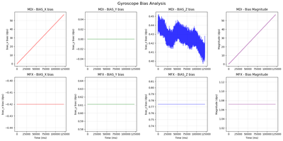

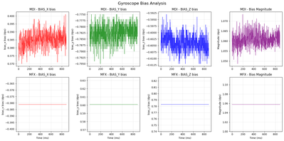

1. Gyroscope Bias Drift
  • MotionDI: Shows significant X-axis bias drift (0-60+ dps over time)
  • MotionFX: Maintains stable bias (~-0.42 dps constant)
  • Question: Is this normal behavior, or should I adjust calibration parameters?

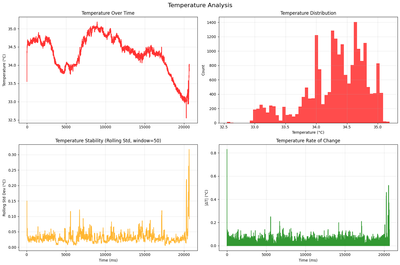

3. Temperature Influence
  • Temperature varies 33-35°C during operation
  • Correlation with bias drift observed (very minimal changes, but changes still)
  • Question: Should I implement temperature compensation? (Even though the ism has built-in compensation)

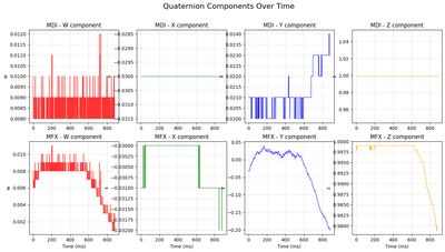

  • Gyroscope magnitude around 1.0-1.2 dps

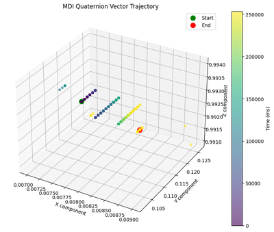

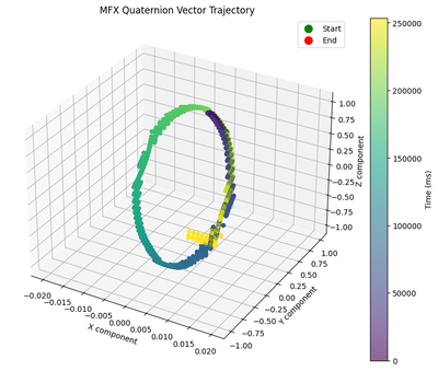

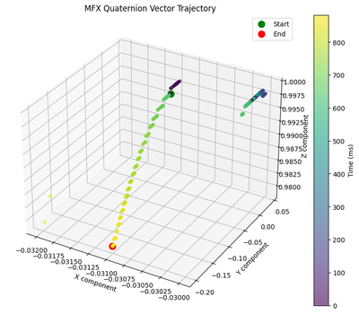

  • MotionFX quaternion trajectory shows more circular pattern
  • MotionDI quaternion trajectory shows more linear segment\

  1. Bias Calibration: Why does MotionDI show significant X-axis bias drift while MotionFX remains stable? Should I adjust gbias_gyro_th_sc parameter?

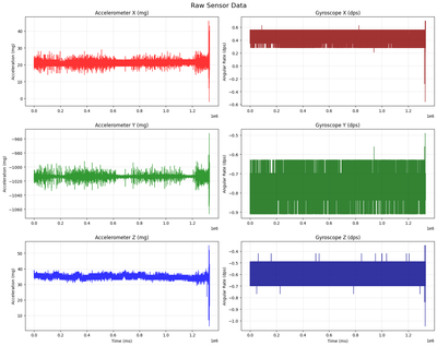

[EDIT]: I have now also done some extra testing. I found the following "noise floor" for my sensor:
accel_x_mg - Mean: -62.39, Std Dev: 0.61, Median: -62.00, Min: -68.00, Max: -57.00
  3 Noise Floor accel_x_mg: 0.00182749 mg
accel_y_mg - Mean: -1010.81, Std Dev: 0.54, Median: -1011.00, Min: -1015.00, Max: -1005.00
  3 Noise Floor accel_y_mg: 0.00161997 mg
accel_z_mg - Mean: -16.90, Std Dev: 1.12, Median: -17.00, Min: -30.00, Max: -12.00
  3 Noise Floor accel_z_mg: 0.00335705 mg
gyro_x_dps - Mean: 0.38, Std Dev: 0.04, Median: 0.42, Min: 0.14, Max: 0.70
  3 Noise Floor gyro_x_dps: 0.00227631 mg
gyro_y_dps - Mean: -0.78, Std Dev: 0.04, Median: -0.77, Min: -1.05, Max: -0.49
  3 Noise Floor gyro_y_dps: 0.00209153 mg
gyro_z_dps - Mean: -0.60, Std Dev: 0.04, Median: -0.63, Min: -0.91, Max: -0.35
  3 Noise Floor gyro_z_dps: 0.00204885 mg
Magnitude of Acceleration: 1012.88 mg
Magnitude of Gyroscope: 1.06 dps
And have used these settings in the parameters for MotionFX, however, I still see a steady drift overnight (21 degrees of change in 16 hours)

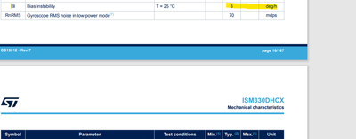

Hi @mfo ,
0.9 deg over 12 hours is equivalent to 0.075 deg/hr, given that BI for our gyroscopes is around 3 deg/hr. From datasheet:
What is your application? What values do you want to achieve?

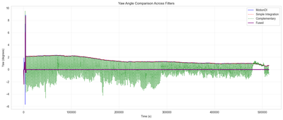

Currently, we have MotionDI set up with a quaternion reference and have a simple complementary filter running in parallel that resets every `n` minutes so that we can keep detecting true changes for azimuth.
Using this technique, we have been able to get azimuth a lot more stable:
However, we were still wondering if there is no better way to do this using just motionFX or just motionDI? It seems weird that, even using parameter optimization, we can not get overall good results for tracking changes in a stationary system.
