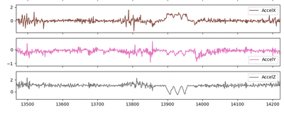

Hi!
I inherited a project and we're seeing strange accelerometer values and I'd like to get a sanity check on my configuration. when Idle and flat, I see 1g on Z, 0g on X and Y. When my device is moving I see peaks on many axes beyond 1g, eg 2.5 on X or Z, and it does not seem real. Here is downsampled data from a log file. X (brown) goes from +1.5g to -1.5g, Z (gray) is over 2.3g. I am not expecting such numbers during a short banked turn at ~15 mph
This is my init. I'm expecting 104Hz data rate, 4g acc scale, 1000dps gyrp scale

Federica Bossi
Hi @ms360 ,
We don't expect such values. Could you try repeating the test by implementing our examples available on GitHub? Just to exclude any issues related to your code.
Thanks Federica. Bench testing always looks good. I get about 1G magnitude between the 3 axes. Even motion FX shows good rotation data on the bench.
Field data is always where we see the weird values. Our logging is only at 4Hz due to space constrictions.
I'll compare your github examples against what we have, and go from there.

I changed my code to reflect the settings in the example product. Still seeing 2.5g peaks on 2 axes.
I ordered an IMU data logger to provide another source of measurements. I will report back next week after a field test.
