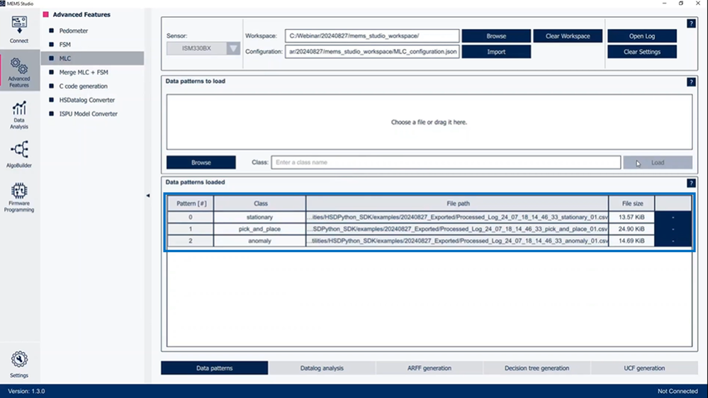

Figure 4: In the MLC tool of MEMS-Studio, the three files generated can be imported with their label
