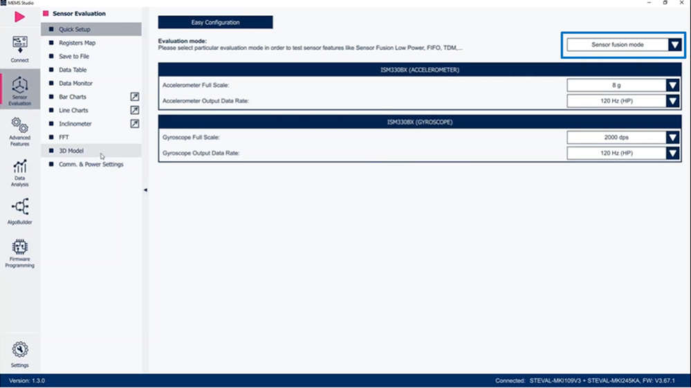

Figure 13: In the Quick Setup section of MEMS-Studio, ISM330BX can be easily configured and the evaluation mode can be changed to sensor fusion
