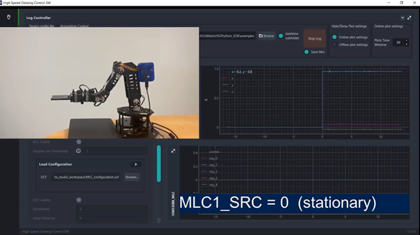

Figure 11: Robotic arm – Detection of stationary state

Figure 9: We can see the result at 0 when there is no movement: this is the stationary class
