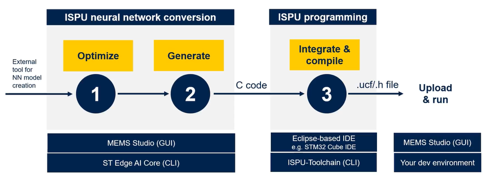

Figure 8: The .ucf file generated by MEMS-Studio can be imported in the High Speed Datalog GUI to test it with real time data

Figure 12: MEMS-Studio can be used also for evaluation with the compatible boards, for instance the Professional MEMS tool board
