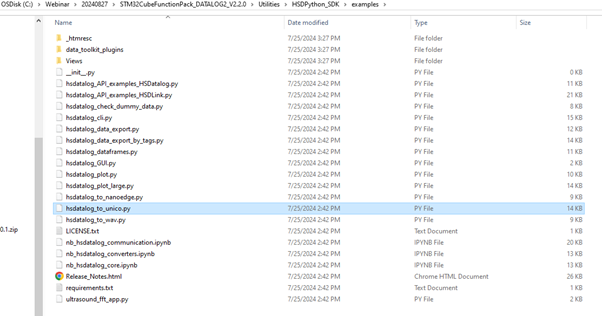

To import into MEMS-Studio the datalogs we have previously acquired, we need to convert them to a compatible format. We can do this through the HSDatalogApp through Unico script, which is provided inside the Python SDK installed as described in the article: “How to acquire a datalog for your anomaly detection application with ISM330BX".
Figure 1: The datalog we have previously acquired using High Speed Datalog is converted to a compatible format to be imported in MEMS-StudioFigure 1: The datalog we have previously acquired using High Speed Datalog is converted to a compatible format to be imported in MEMS-Studio

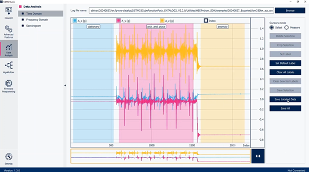

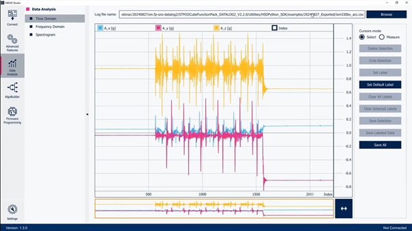

Now, we can open MEMS-Studio in offline mode without any board connected to the PC. In the data analysis tool, we can import data to do some data cleaning and labeling.
Figure 2: The collected data is imported in MEMS-StudioFigure 2: The collected data is imported in MEMS-Studio
We can set the labels for the three classes we want to detect so that the single file previously acquired can be split into three files, one per class. Note that in this simple example we have used one single acquisition, but you can have multiple datalogs in a real application.
When we have completed the labeling part, we can click on Save labeled data.
Figure 3: The collected data is labeled and divided into three files, one per class (stationary, pick and place movement and detected anomaly)Figure 3: The collected data is labeled and divided into three files, one per class (stationary, pick and place movement and detected anomaly)

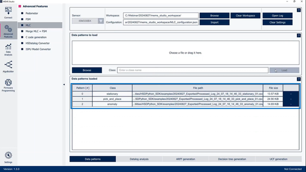

Then in the MLC tool of MEMS-Studio, the three files generated can be imported with their specific label (stationary, pick and place movement, and anomaly).
Figure 4: In the MLC tool of MEMS-Studio, the three files generated can be imported with their labelFigure 4: In the MLC tool of MEMS-Studio, the three files generated can be imported with their label

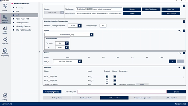

An analysis of the imported data can be done to have some suggestions on the parameters to be used to. Alternatively, we can proceed with the manual configuration of the machine learning core parameters like inputs, and window features.

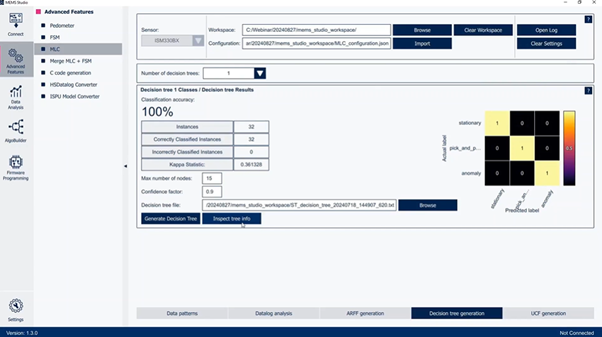

Figure 5: In the MLC tool of MEMS-Studio, the manual configuration of the machine learning core parameters like inputs, window features and so on is performedFigure 5: In the MLC tool of MEMS-Studio, the manual configuration of the machine learning core parameters like inputs, window features and so on is performed
At the end of this step, the tool generates first a file containing the features computed in the final window. We can generate the decision tree model and the tool provides some information about the accuracy of the generated model.
Figure 6: In the MLC tool of MEMS-Studio, the decision tree can be generated and the user can also visualize its infoFigure 6: In the MLC tool of MEMS-Studio, the decision tree can be generated and the user can also visualize its info

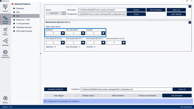

Finally, we can choose the output values corresponding to the three classes defined, for instance, zero for stationary, four for pick and place and eight for anomaly.
The tools generate a configuration file containing the sensor configuration.
Figure 7: In the MLC tool of MEMS-Studio, the .ucf file can be generatedFigure 7: In the MLC tool of MEMS-Studio, the .ucf file can be generated

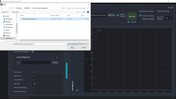

The configuration for the sensor generated by MEMS-Studio can be imported in the High Speed Datalog GUI to test it with real time data.
Figure 8: The .ucf file generated by MEMS-Studio can be imported in the High Speed Datalog GUI to test it with real time dataFigure 8: The .ucf file generated by MEMS-Studio can be imported in the High Speed Datalog GUI to test it with real time data

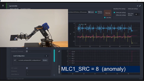

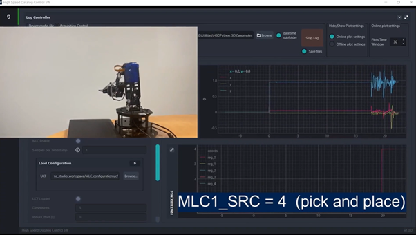

The output of the machine learning core is available in the MLC source register. The STWIN.box firmware reads the register and sends it to the High Speed Datalog GUI. We can see the result equal to 0 when there is no movement: This is the stationary class.
Figure 9: We can see the result at 0 when there is no movement: this is the stationary classFigure 9: We can see the result at 0 when there is no movement: this is the stationary class
The result is equal to 4 when the pick and place movement is recognized.
Figure 10: We can see the result at 4 when there is pick and place movement: this is the pick and place classFigure 10: We can see the result at 4 when there is pick and place movement: this is the pick and place class
The result is equal to 8 when the anomaly has been detected on the robot.
Figure 11: We can see the result at 8 when there is anomaly detection: this is the anomaly classFigure 11: We can see the result at 8 when there is anomaly detection: this is the anomaly class

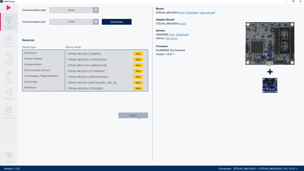

However, MEMS-Studio can be used also for evaluation with the compatible boards, for instance, the Professional MEMS tool board, which is shown in Figure 12.
Figure 12: MEMS-Studio can be used also for evaluation with the compatible boards, for instance the Professional MEMS tool boardFigure 12: MEMS-Studio can be used also for evaluation with the compatible boards, for instance the Professional MEMS tool board
With this board connected, you can evaluate the different features available in ISM330BX.

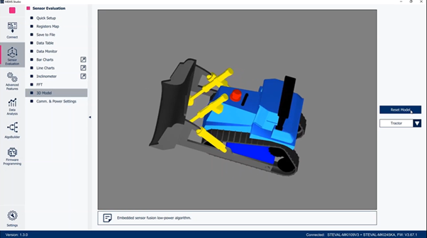

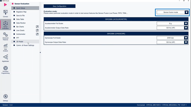

In the [Quick Setup] section, you can easily configure the sensor: Changing the evaluation mode to sensor fusion (see Figure 13) in the 3D model section, you can evaluate the sensor fusion low power running on ISM330BX (see Figure 14).
Figure 13: In the Quick Setup section of MEMS-Studio, ISM330BX can be easily configured and the evaluation mode can be changed to sensor fusionFigure 13: In the Quick Setup section of MEMS-Studio, ISM330BX can be easily configured and the evaluation mode can be changed to sensor fusion
 Figure 14: In the 3D model section of MEMS-Studio, the sensor fusion low power running on ISM330BX can be evaluatedFigure 14: In the 3D model section of MEMS-Studio, the sensor fusion low power running on ISM330BX can be evaluated

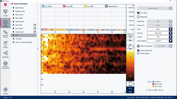

Another important feature available in MEMS-Studio is the FFT tool, which shows the fast Fourier transform of the data coming from the accelerometer and gyroscope.
Figure 15: In FFT section of MEMS-Studio, the Fast Fourier transform of the data coming from the accelerometer and gyroscope of ISM330BX can be evaluatedFigure 15: In FFT section of MEMS-Studio, the Fast Fourier transform of the data coming from the accelerometer and gyroscope of ISM330BX can be evaluated
