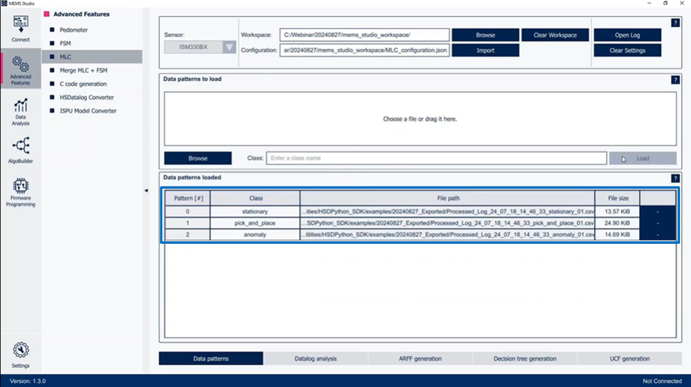

Figure 3: The collected data is labeled and divided into three files, one per class (stationary, pick and place movement and detected anomaly)
Figure 4: In the MLC tool of MEMS-Studio, the three files generated can be imported with their label
