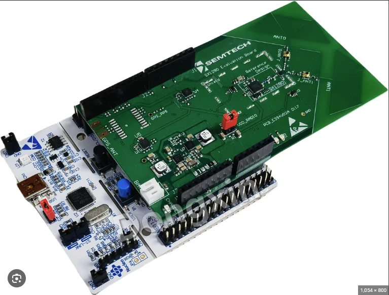

My dev board is the official... the SEMTECH "SX1280ED1ZHP", it's included a nucleo + daughter board with SX1280.

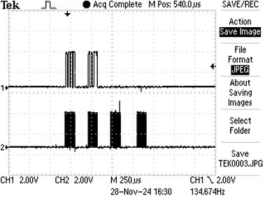

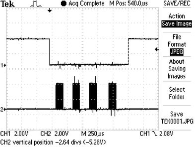

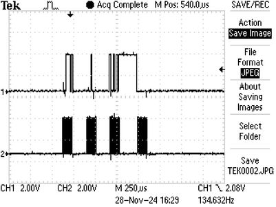

Second thing, a see Something wrong at scope.

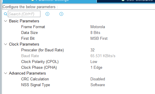

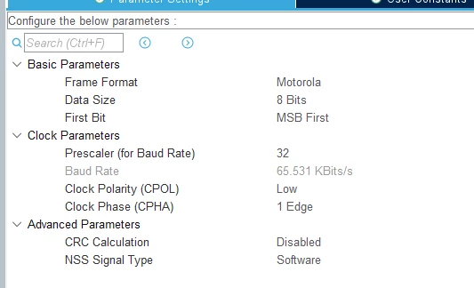

#IOC Spi configuration

Channel 1 : CS / Channel 2 : SCK
Channel 1 : MOSI / Channel 2 : SCK
Channel 1 : MISO / Channel 2 : SCK

@JL_Loyd wrote:
My dev board is the official... the SEMTECH "SX1280ED1ZHP", it's included a nucleo + daughter board !
Does that not come with some demo or example software?
