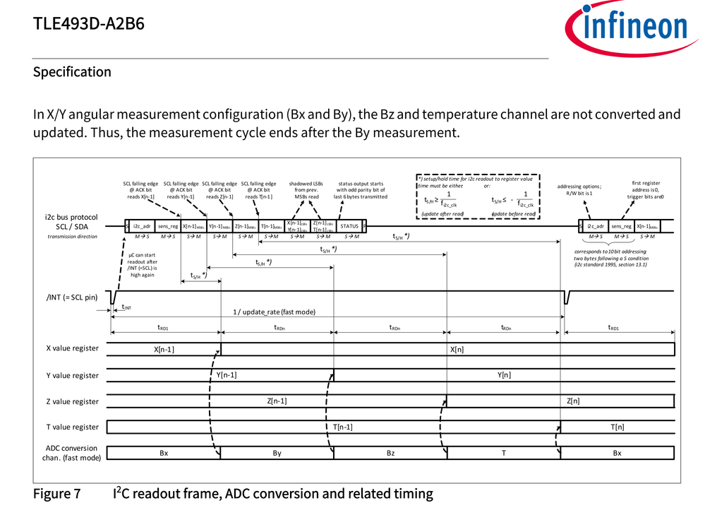

I am currently trying to communicate with the TLV493D-A1B6 3D hall sensor. As board, I'm using the NUCLEO-F103RB. To make sure I didn't mess up any connections or anything else, I verified my setup with an ADS1015 adc which I can read out over I2C. Unfortunately, I am not able to find a valid address whilst sweeping through all possible addresses. I always get "HAL_ERROR" after using the following routine. With my other I2C device, I get 3 valid addresses.

Here I am again. My code works now :D
As described in the data sheet, the I2C communication can only start after the SCL interrupt, driven by the slave, is over. I currently fixed this issue by starting the first read command after I receive an interrupt on the SCL line. After that, I disable the INT bit in the register 0x11. With this setting, I can receive data with the following command:

Jiimmy
It seems to be a hardware issue. I am currently working on it to figure out what exactly the problem is.
Jiimmy
Unfortunately, I still did not figure out what exactly the error is. I managed to communicate with my sensor over I2C with an Arduino UNO board. Whilst using my ST Board, I observed that my sensor is pulling down the SCL line periodical. When I disconnect the SCL line to the sensor it, everything is fine, except the ACK is not sent, because my sensor has obviously no CLK.
HAL_I2C_Master_Receive_IT(&hi2c1, ADDRESS, rbuffer, sizeof(rbuffer));
Hi! I am relatively new to the stm32 world, and after making it through a few blinky exercises, I would like to try writing a driver for this sensor.
Something that befuddles me about this particular sensor is its use of the SCL line as an interrupt line. I'm trying to figure out how to successfully read from the sensor, and I think I'm a few steps behind where you were at when you wrote this post.
So far, I have set up my i2c SDA/SCL lines, and can successfully configure the sensor. But I think I need to also enable a GPIO exti interrupt on the SCL line, to trigger an interrupt on the falling edge before I initiate any i2c transactions to read sensor data.
