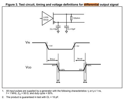

Hello, I measure the output differential voltage of the drivers (with 100ohm termination resistor) and it is always higher than 0.4V that is referred to the datasheet. What I measure is about 0.68V. Is that normal?

Is this the test circuit you have used.
The datasheet values are according to this test circuit.

The chip is supplied with 3.3V and I measure on a termination resistor of 100Ohm as in picture 3 of the datasheet, what I don't use is the two capacitors.
To have a credible result, you should use the same conditions as described in the datasheet (you should use the 2 capacitors).
