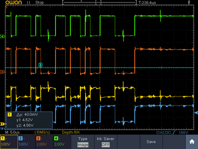

STM32 FDCAN: Frames visible on CANable (candump) but TX still reports ACK error — scope shows ACK notch
suyog1

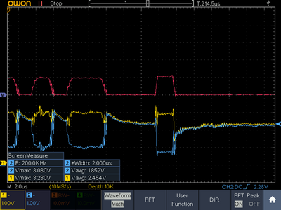

TL;DR:
  • Two-node bus: STM32 (FDCAN1)CANable (SocketCAN) at 500 kbit/s
  • candump can0 shows frames from STM32, but STM32 keeps flagging ACK error and increments TxErrorCnt.
  • Scope on CANH/CANL (diff trace CH1–CH2) shows a dominant ACK bit in the ACK slot (!)
  • External loopback works.
  • Looks like my MCU isn’t “seeing” the ACK at its RX input—looking for eyes on transceiver mode pins, RX pin mapping/AF, and timing.

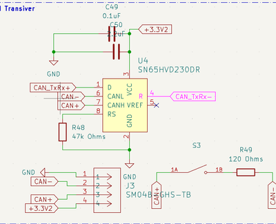

Hardware
  • MCU: STSpin32G4
  • Transceiver: SN65HVD230DR
  • Other node: CANable / candleLight  on Linux as can0.
  • Wiring: STM32 TXD/RXD ↔ CAN transceiver ↔ twisted pair to CANable.
  • Termination: 120 Ω at each end (I can measure ~60 Ω between CANH–CANL with power off; will re-check if requested).
  • Ground: Common GND between boards.
If helpful, I have shared the schematic snippet for the transceiver pins .

  • candump sees frames from STM32 in normal mode.
  • Scope on CANH/CANL shows clean dominant bits. The CH1–CH2 differential (pink) clearly shows a dominant pulse in the ACK slot.
Fails

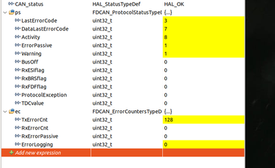

  • In normal mode, FDCAN reports ACK error on every frame; TxErrorCnt climbs (I previously hit Error Warning/Passive).
 Any insights or “you missed this obvious thing” would be hugely appreciated. Thanks!
suyog1

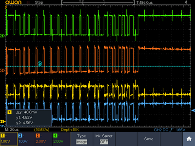

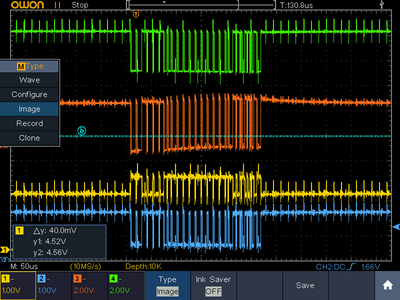

There was an manufacturing defect in my board. The D and R pins were shorted while the MCU was soldered IG... Anyways, I checked with the other board which did not have an short and it worked very well.
@all Thankyou for your help.

suyog1

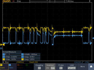

Channel 1 - CAN H
Channel 2 - CAN L
Channel 3 - D
Channel 4 - R

Possibile problems in You configuration:
1) The 47k Resistor on the RS pin will reduce the slew rate, this could be to slow for 500 kBit/s.
2) You are setting the sample point at about 94%, normaly the sample point is set to 87,5% (CanOpen).
Try the Can bit timing calculator from Kvaser (https://kvaser.com/support/calculators/can-fd-bit-timing-calculator/)
As said by @MHoll.2 , your sample point is set at a too late position on the bit time. CanOpen recommands ~87,5%.
Try these timing parameters set at 87,87%:
I do agree also on the fact that 47k is a bit high value, try to ground Rs pin.
suyog1
