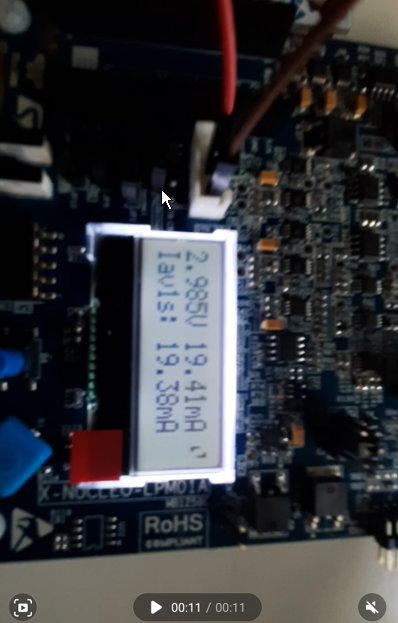

If I understand : You wanted to measure the current when the xshutdown pin is forced to zero by the microcontroller. And you measure more than the value mentionned in the datasheet? What is the current value you were measuring.
Thanks
Julien

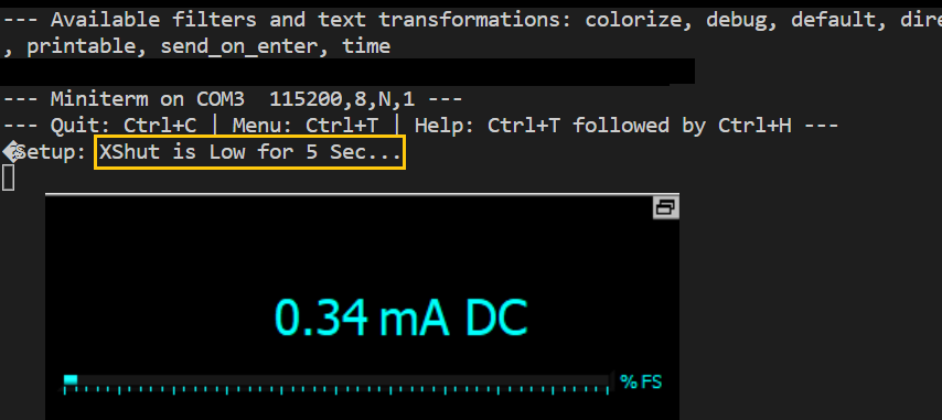

Thank you Julien for your reply, i made 2 kinds of measurements one with XSHUT pin connected to the microcontroller & the Other I disconnected the pin. the firmware cycle is:
1- Wakeup (Ideal)
  • With XSHUT = 0.34mA
  • Without = 0.01mA

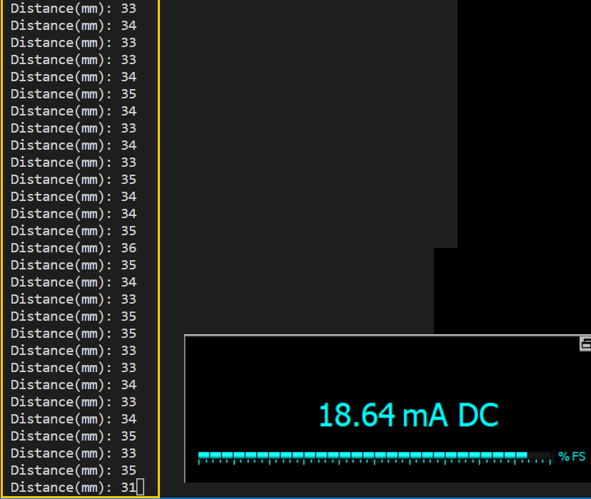

2- Measuring
  • Same for both = 14.5mA (With Budget 20mS).

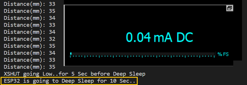

3- Sleep
  • With XSHUT = 0.04mA
  • Without = 0.01mA
Based on this result, my decision was to leave the XSHUT unconnected (The Sensor is mounted on a breakout board with pull-up resistances). But I was hoping to have better power performance when using the XSHUT pin.

Please confirm me. What is the microcontroller are you using ? When you say unconnected, do you mean that you do not control the xshut down pin but you connect this PIN to VCC via a pull up resistor?
If you always connect the the xshut pin to VCC how do you put the ToF in the sleep mode?

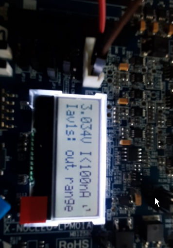

What do you mean the sleep mode ? If you want to gain in power consumption you need to put the ToF into the HW stdby mode (xshut = 0)
I measure today on the VL53L4CD, I get 19 mA in ranging mode and less that 0,1 uA in HW standby mode (xshutdown driven to zero by the microcontroller ). The VL53L4CD and VL53L0X have the similar electrical performance. I will do the same measurement on the VL53L0X.
Thanks
Julien

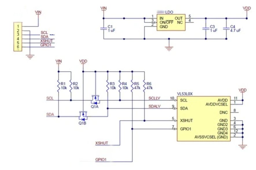

When you say unconnected, do you mean that you do not control the xshut down pin but you connect this PIN to VCC via a pull-up resistor?
Yes, according to the schematic of the breakout board of the Sensor that I have:

I measure today on the VL53L4CD, I get 19 mA in ranging mode and less than 0,1 uA in HW standby mode (xshutdown driven to zero by the microcontroller ).
The VL53L4CD and VL53L0X have similar electrical performance. I will do the same measurement on the VL53L0X.
I get the same measure for the ranging (time budget 33mSecand).
but the standby is much higher.
However when the Microcontroller goes into the deep sleep mode (the vdd to the sensor is off).
still don't know what prevents me from getting the less than 0.1uA !!

I'm going to guess that if you have a pull-up on the Xshut line, you need to burn power to pull it down. And that is where you are using the power. With the Xshut down held low, that senor is basically a brick.

1- This is not the 47K pull up resistor who burn 312uA ! :thinking_face:
So why when Xshut is low there is still a consumption ?
