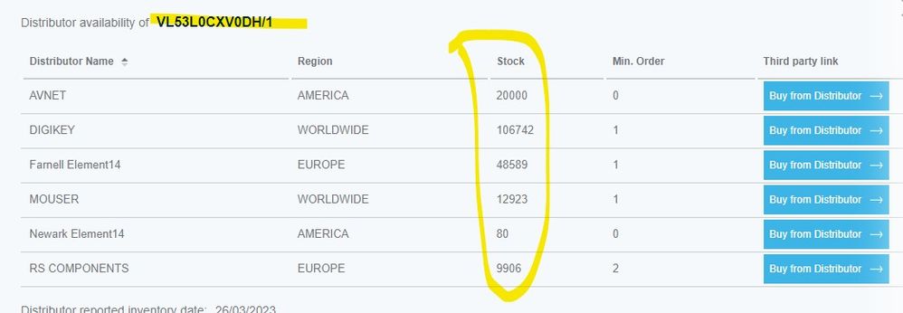

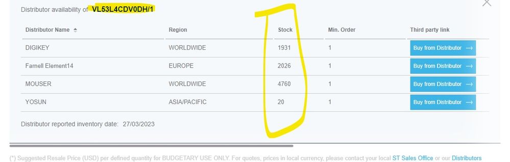

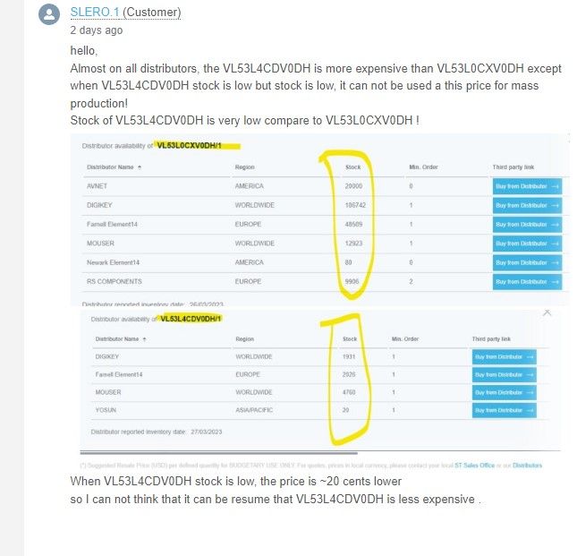

hello,
Almost on all distributors, the VL53L4CDV0DH is more expensive than VL53L0CXV0DH except when VL53L4CDV0DH stock is low but stock is low, it can not be used a this price for mass production!
Stock of VL53L4CDV0DH is very low compare to VL53L0CXV0DH !
0693W00000aJkc3QAC.jpg0693W00000aJkcDQAS.jpgWhen VL53L4CDV0DH stock is low, the price is ~20 cents lower
so I can not think that it can be resume that VL53L4CDV0DH is less expensive .
Hello
Thanks for the interest in ST products.
You are right the stock of VL53L4CD at distributors are very low while we have stock at ST. We will contact distributors.
Regarding the prices given by distributors, they are not under ST control. But the VL53L4CD should be at slightly lower price than VL53L0X for equivalent volumes.
