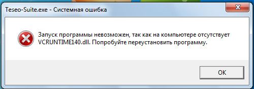

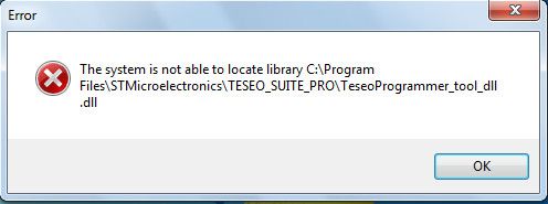

Hi
So that's the point, Teseo-Suite throws an error when you press the STA808x / 9x FW Upgrade button in the Tools menu?
Hi
Which version of Teseo-Suite are you using?
Did you install Teseo-Suite as Administrator?
You can try using the attached stand-alone version of firmware-update.
Rgards
Francesco
Hi
thanks for the help
version of Teseo-Suite - 5.2.3.4
