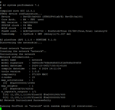

Thanks for your answer, I will try on my side  and give you a response as soon as I can.
For your information here is the inference time for NUCLEO-F401RE we have reproduced on ST Edge AI Dev Cloud.
Best regards,
