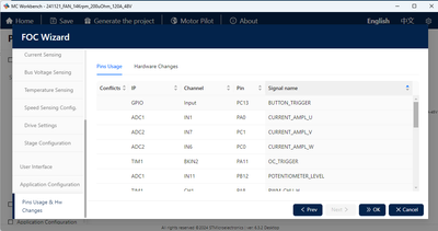

2024-11-29 4:21 AM
Tools : MotorControl Workbench_6.3.0, CubeMX_6.12.0, CubeIDE_1.15.0
Issue : The start/stop button is configred in .stwb6 as attached but this button does not shown in "User Interface" and "Pin Usage & HW Changes"tab. I tried to generate the project this button is not created.
Please help to solve this issue.
Thanks and regards,
2024-12-03 2:42 AM
Hello @SJ_JG and welcome to ST community,
I have the same behavior on my side but Start/Stop button appears correctly using our latest MotorControl Workbench 6.3.2 available here.
Is it possible for you to share your custom board .json file to investigation this point?
