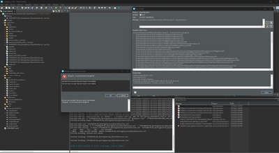

I have been trying for several weeks to run the Getting Started Object Detection demo from the STM32 GitHub repository.
I followed both the GitHub and all the steps from the official guide:
“How to run AI models from model zoo on STM32N6” by @B.Montanari   (ST Employee)— but the STM32CubeIDE part does not work for me.
Each time I try to open the Debug Configuration or start the debugger, I get the following error:
An error has occurred. See error log for more details.
Range [0, -1] out of bounds for length 44
I saw that @Ghofrane GSOURI (ST Employee) suggested removing this line from the .project file:
<nature>com.st.stm32cube.ide.mcu.MCUAppSProjectNature</nature
After doing that, I can open the Debug Configuration and start debugging,
but when I upload the project to my STM32N6570-DK board, the demo doesn’t run properly(black screen or the ia doesn't work).

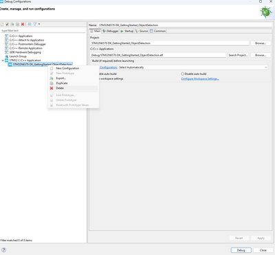

Hi @Goat_abdalla,
I tried your object_detection_all_project and successfully ran it.
I had to delete the /debug, build the project and then delete the debug configuration.
I never encountered the range error.
Please try what I did, we never know, else, is it possible for you to uninstall any cubeIDE on your pc and then reinstall the version 1.18.1 (prior to 1.19.0) and see if it helps?
If it doesn't, please create a thread on the tools forum board as this seems to be purely a cubeIDE issue...
Let me know what results your tests give.

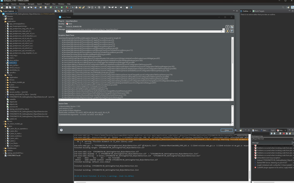

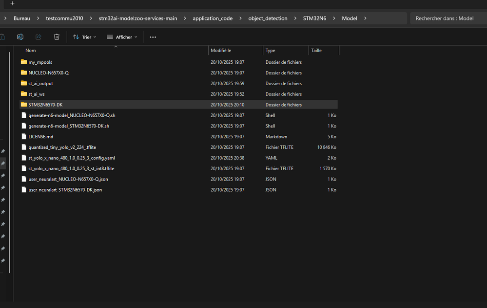

Hi @Goat_abdalla,
The Range error should be only present in 1.19.0. In your screenshot you are using this version, but it seems that you also get this error on other CubeIDE versions? (It would be strange)
When using model zoo, make sure to use the yaml file in the same folder as the model (and edit it to deploy the model) Could you please share the logs you get?
Could you please try to deploy this one:stm32ai-modelzoo/object_detection/st_yolo_x/ST_pretrainedmodel_custom_dataset/st_person/st_yolo_x_nano_480 at main · STMicroelectronics/stm32ai-modelzoo
using the yaml alongside the model.
Make sure to install the model zoo services in a virtual env as explain in the main readme.
Have a good day,
Julian
Hello, julian
Thank you so much for your help.
I confirm that I'm using the YAML file in the same folder as the model as recommended.
However, I still get the same "Range [0, -1) out of bounds" error.
I have also tested with STM32CubeIDE version 1.17.0, and I still encounter the same problem.

├── 📁 Model/
│   ├──  st_yolo_x_nano_480_1.0_0.25_3_st_int8.tflite
│   ├──   st_yolo_x_nano_480_1.0_0.25_3_config.yaml
│   ├──  quantized_tiny_yolo_v2_224_.tflite
│   ├── 📁 my_mpools/                  (Memory pool configs)
│   │   ├── stm32n6-app2_NUCLEO-N657X0-Q.mpool
│   │   └── stm32n6-app2_STM32N6570-DK.mpool
│   ├── 📁 NUCLEO-N657X0-Q/
│   │   ├── network_data.hex
│   │   ├── network.c
│   ├── 📁 STM32N6570-DK/
│   │   ├── network.c
│   │   ├── network.h
│   │   ├── network_ecblobs.h
│   │   ├── network_generate_report.txt
│   │   ├── st_yolo_x_nano_480_1.0_0.25_3_st_int8_OE_3_2_0_Q.json
│   │   └── st_yolo_x_nano_480_1.0_0.25_3_st_int8_OE_3_2_0.onnx
│   ├── 📁 st_ai_output/
│   │   ├── network.c
│   │   ├── network.h
│   │   └── ... (9 files)
│   ├── 📁 st_ai_ws/
│   │   ├── build_network/
│   │   ├── network.h
│   │   └── neural_art__network/
│   ├──  generate-n6-model_NUCLEO-N657X0-Q.sh
│   ├──  generate-n6-model_STM32N6570-DK.sh
│   ├── user_neuralart_NUCLEO-N657X0-Q.json
│   ├──  user_neuralart_STM32N6570-DK.json
│   └──  LICENSE.md

Hello @Goat_abdalla,
I am not sure to understand, in all your screens, you seem to use cubeIDE 1.19.0.
Really, this range error was only observed in 1.19.0.
In your yaml, you have this:
tools:
  stedgeai:
    version: 10.2.0
    optimization: balanced
    on_cloud: False
    path_to_stedgeai: C:/Users/@/STM32Cube/Repository/Packs/STMicroelectronics/X-CUBE-AI/10.2.0/Utilities/windows/stedgeai.exe
  path_to_cubeIDE: C:/ST/STM32CubeIDE_1.19.0/STM32CubeIDE/stm32cubeide.exe
Which also suggest that you use the 1.19.0.
Have a good day,
Julian

Hi @Goat_abdalla,
Have a good day,
Julian
