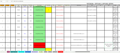

Thank you I got the IO definition sheet. IO Definition sheet for SPC582B60E1CD00X 64 pin MCU which i was looking for.
Can you guide on how to decide pins for a pin. I am working on AVAS system design. Ex. If i want to assign I2c, I2s, SPI to MCU pins.

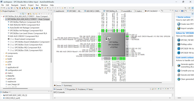

KTANG.9
We have a AVAS reference board and schematic - https://www.st.com/resource/en/data_brief/aek-aud-c1d9031.pdf
User manual - https://www.st.com/resource/en/user_manual/um2719-avas-architecture-based-on-autodevkit-stmicroelectronics.pdf
Sample project - SPC582Bxx_RLA_AEK_AUD_C1D9031 - Avas Compact - Test Application
This is found in the AutoDevKit IDE - https://www.st.com/en/embedded-software/stsw-autodevkit.html
Has graphical pinmap editor to configure the MCU pins.
