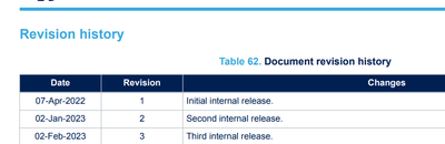

Uwe Bonnes
Chief
STLINK-V3 is firmware locked to STM32 devices. V2 firmware can talk to devices of other brands via JTAG/SWD. . ST stlink software probably not.
@Ozone wrote:
Probably new products, superceeding the SPC5 devices.
Not new as it seems.
From the datasheet it seems to be available since Apr 2022.. It has been available for four years already...
But I don't have any idea about that product.
I didn't catch that.
Although it doesn'ts surprise me. From the description, it sounds like a quite complex and expensive beast, for a special market niche. And probably not with a huge amount of sales.
