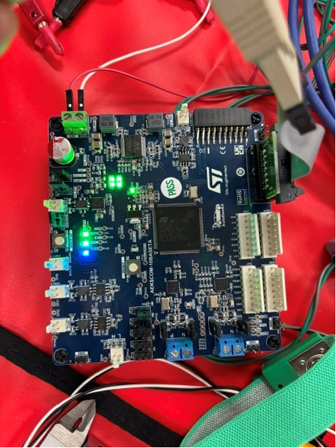

Hello support team,

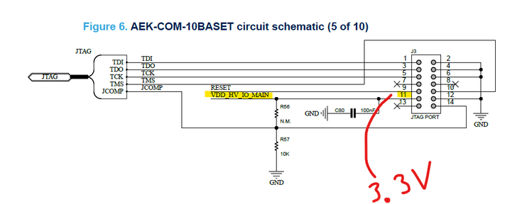

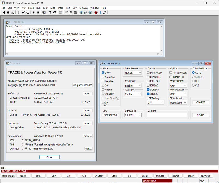

I just received a new AEK-COM-10BASET board and trying to connect Lauterbach debugger with License module for MPC55xx.
Question : How can I connect to the board through Lauterbach debugger & SW?
Currently the SW (TRACE32) shows error message when I press "Up" button.
I have no idea why such "Target Power Fail" error or "Power Down" message is appeared.
Also I checked below 11 pin and the measured voltage is 3.3V.
The jumper (switch) configuration I made are ;
JP1~JP7 : closed = short
J13, J14 : I tried both 1-2 and 2-3 connection
Any comment is appreciated, thanks!

We have not tested the board with Lauterbach. We used OpenOCD as deployed in AutoDevKit Studio.
By the way, our MCU is SPC58EC e not MPC55xx. Might this be the difference?

Hello Team,
I found wrong cable connection and I successfully connected / started debugging through Lauterbach debugger.
Based on it's default basic CMM script I also flashed the sample project's ELF. Looks like working.
Thank you for help!
