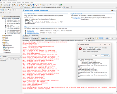

First,
 I'm using SPC582-DIS Board rev 1.1 and AutoDevKit Studio version 2.4.0.

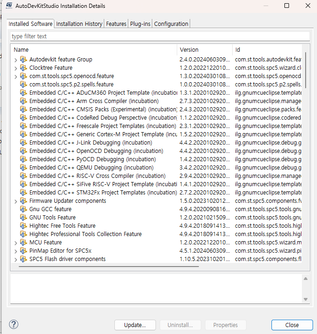

I installed openodc drivers according to the doc named 'How to use OpenOCD and SPC5-UDESTK in SPC5Studio'.
These are located 'AutoDevKitStudio-2.4.0\openocd\docs' and  'AutoDevKitStudio-2.4.0\openocd\drivers'.

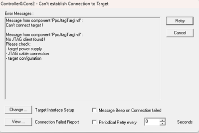

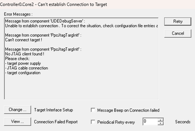

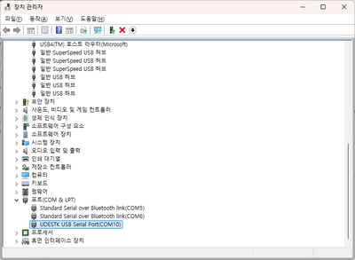

 I'm using SPC582-DIS Board rev 1.1 and AutoDevKit Studio version 2.4.0 and UDE STK 5.2.
I installed PLS UDE Driver and UDE STK 5.2 according to 'SPC5-UDESTK Getting Started' manual.
I used AutoDevKit to make .elf and wsx. And I Opend .wsx by UDE STK.
I swapped USB Driver in two combination cases.
