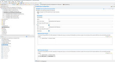

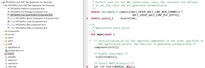

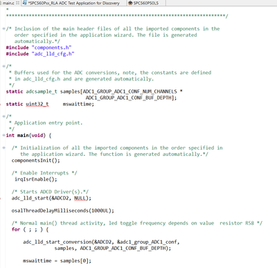

To solve the problem you highlighted, please import the demo "SPC56xx_RLA ADC Test Application for Discovery".
It shows how to use the ADC with the SPC56 microcontroller. You can compare your ADC configuration with the one in the demo
and refer to the main.c file to see how to read data from the ADC.
